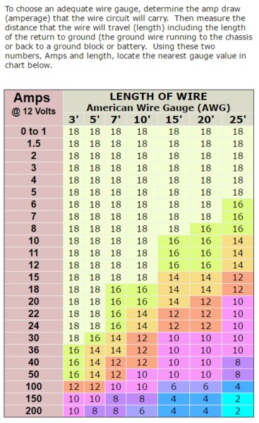

    For wire gauge I would use this. Depending on how far your running it (under the truck and what not) bigger wire may be better (where I get my wire there is no difference in proce between 16-12 gauge wire, so I usually just get 14 or 12 for everything).

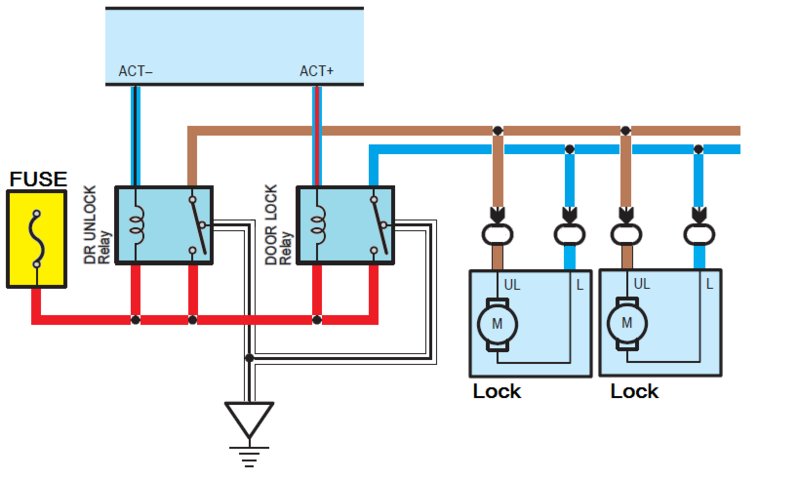

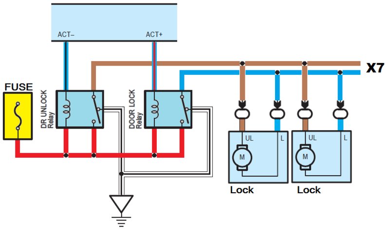

    Yeah I'm not too worried about picking what gauge I run under the truck, that's no big deal... More worried about burning out the wiring in the trucks factory harness, or the relay. The trucks door lock fuse is listed as a 20A but I don't know what the factory locks draw, I'm nervous about adding ~14A on top of what the factory circuit is running and burning out the wiring or damaging the relay.
    As the door locks are run on 2 wires and the polarity is reversed for lock/unlock I figure I would need 2 relays each with diode to control getting the correct polarity to the tailgate.

    In that case just run a relay. Most are rated for 40 amps so your fine there. Just fuse the 12v source (battery or add a fuse in dash) going into the relay and your good to go. With the relay there isn't going to be much draw on the stock system so you should be fine there.
    Yeah sounds like two relays will be needed.
    Sounds like you got it handled :cheers:

    Hopefully, thanks!
    And now that I think about it I don't need diodes, just 2 relays.
