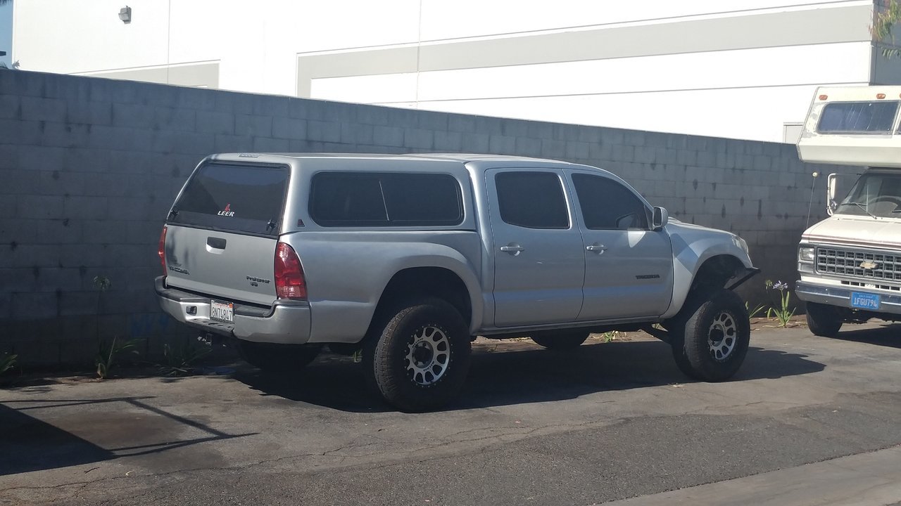

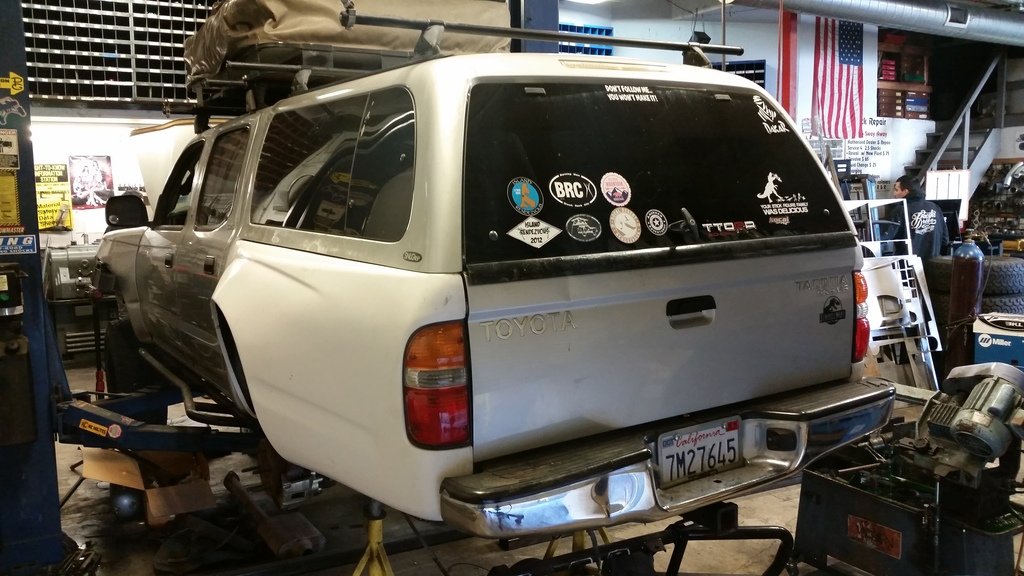

    Love that lookout. How easy were those glassworks bedsides to install and put your camper back onto? Looks really nice!
  4. Sep 15, 2016 at 2:25 AM
    #24
    hudhawk
    hudhawk #texasforever
    Jan 27, 2011
    #50037
    2,022
    Hudson
    California
    TRD Off Road
    Rust, lots of rust

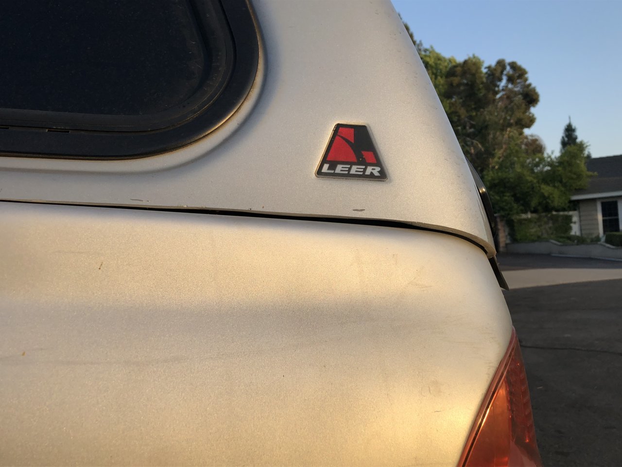

    The glassworks bedsides were not hard to install, little bit of sanding and fitting but nothing major. As for the shell, I had to cut the bottom lip off of it in order to mount it back on the bedsides.

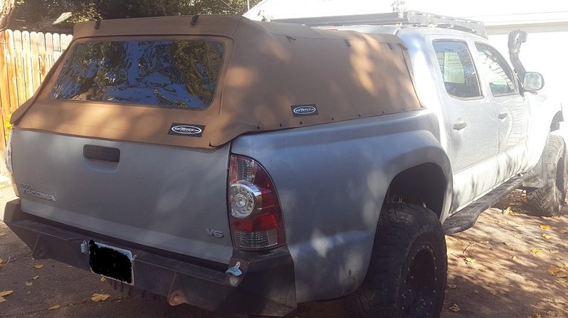

    I finally ordered and installed a softopper. Install was easy but I had to modify the front clamps since my bedcage runs right next to the factory Uni-strut Channel. I also had to drop the pivot pins to the lowest position to ease the snapping of the snaps. I think the canvas sides need to be about 3/4" - 1" longer which is why I am going to make a new pivot bracket that lowers the overall height of the frame.
    I am also considering ditching the factory uni-strut and cutting some steel angle and attaching the aluminum channel to that so I won't have to use the clamps. Ill update the progress.

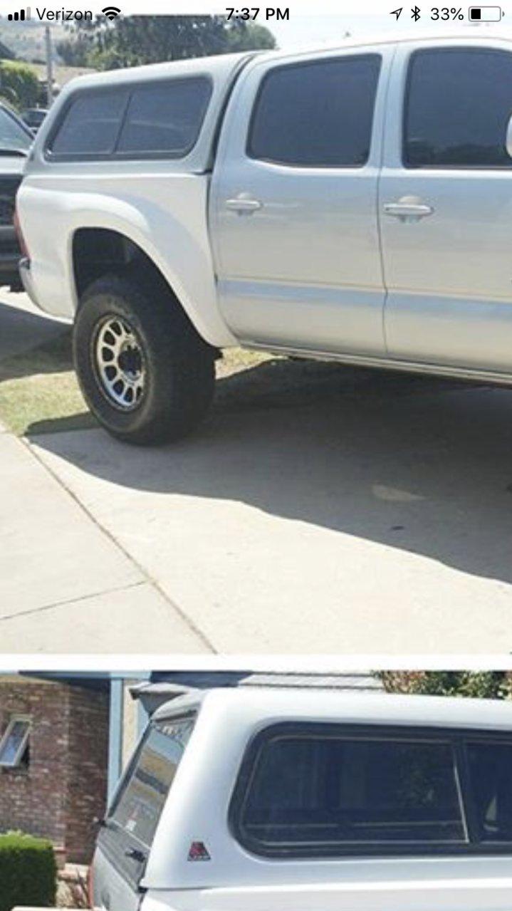

    @hudhawk what fenders are those? I thought that first pic was my truck, looks exactly like mine haha

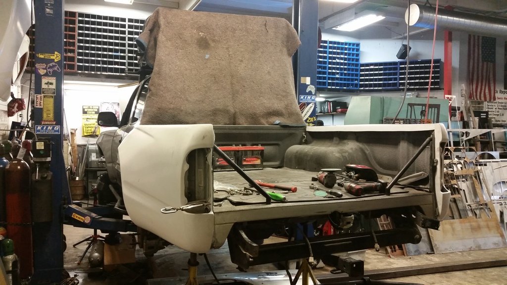

    Camper shell mounted on new bedsides! Internal bracing and bed cage will be added.

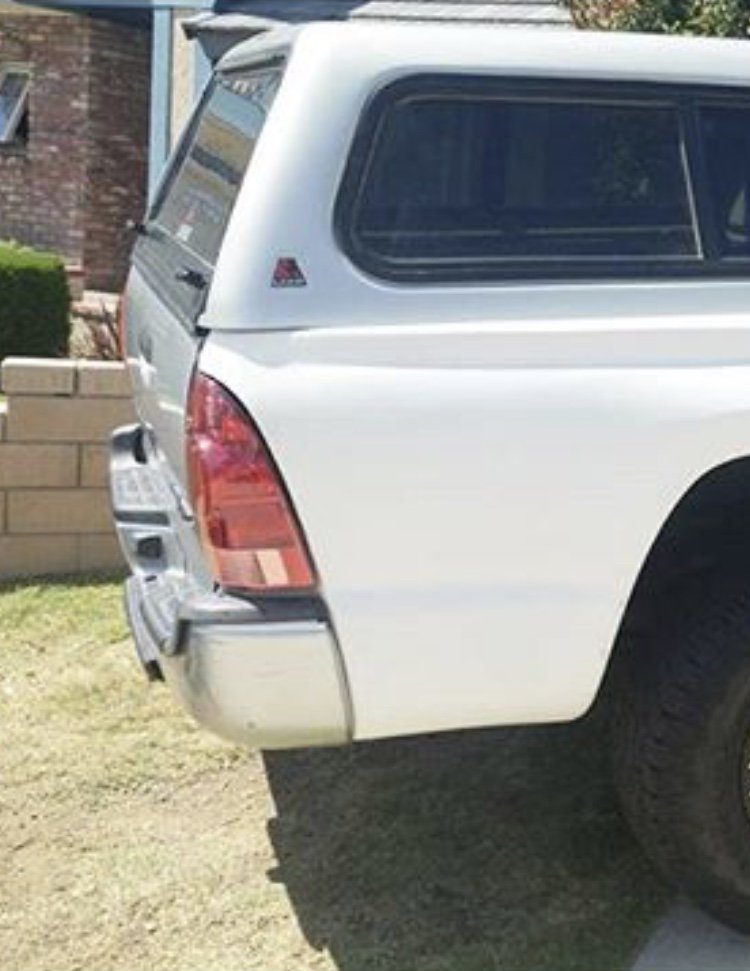

    Gotta question for y’all. I am wondering what the least aggressive fiberglass fenders are out there on the market, that I can also make work with a cap, my bedsides decided to start rusting under the flares, but I’m really wanting to keep the little bit of “stance” I have at the moment.

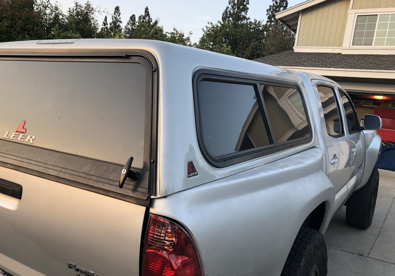

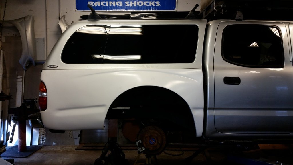

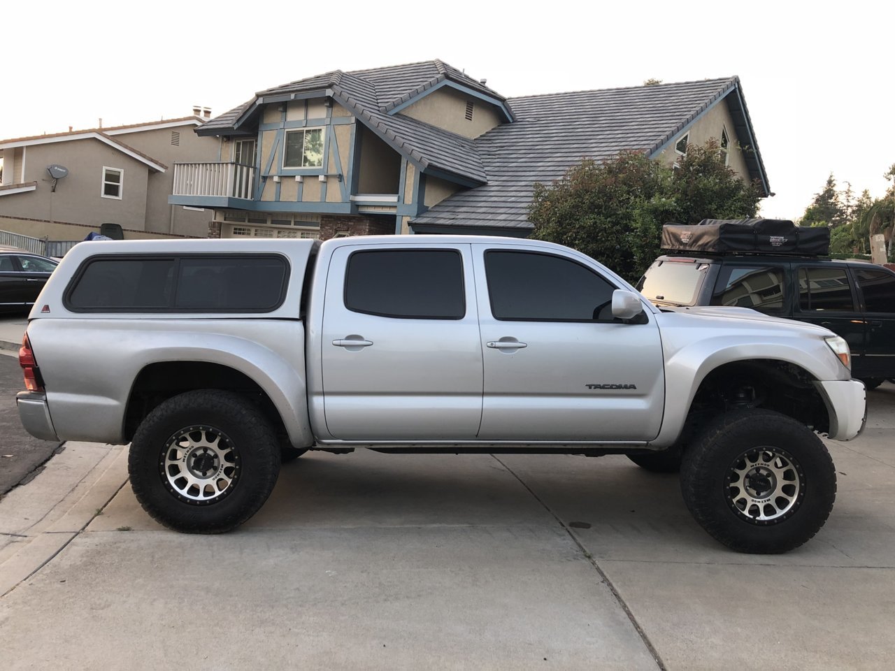

    The Rebel looks like it has a lip that covers the top of the stock bedside. Mine was the same way and it had to be cut off to sit flush on the bedsides. The bed rail mounts did not work right either without cutting off the lip. It’s not perfect but I am happy with how it turned out. Just gotta finally paint my bedsides now haha
    Before
    After
  20. Jul 24, 2018 at 6:39 PM
    #40
    Sdfitted
    Sdfitted Well-Known Member
    Oct 13, 2012
    #88885
    83
    AJ
    San Diego
    DCLB
    Icon 2.5 icon uppers
    Holy crap you cut a lot! Really surprised it still looks about flush with the cab.
