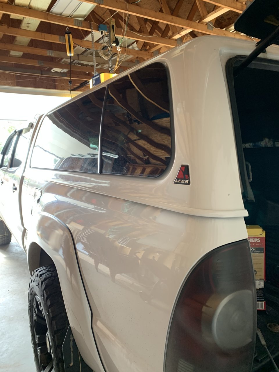

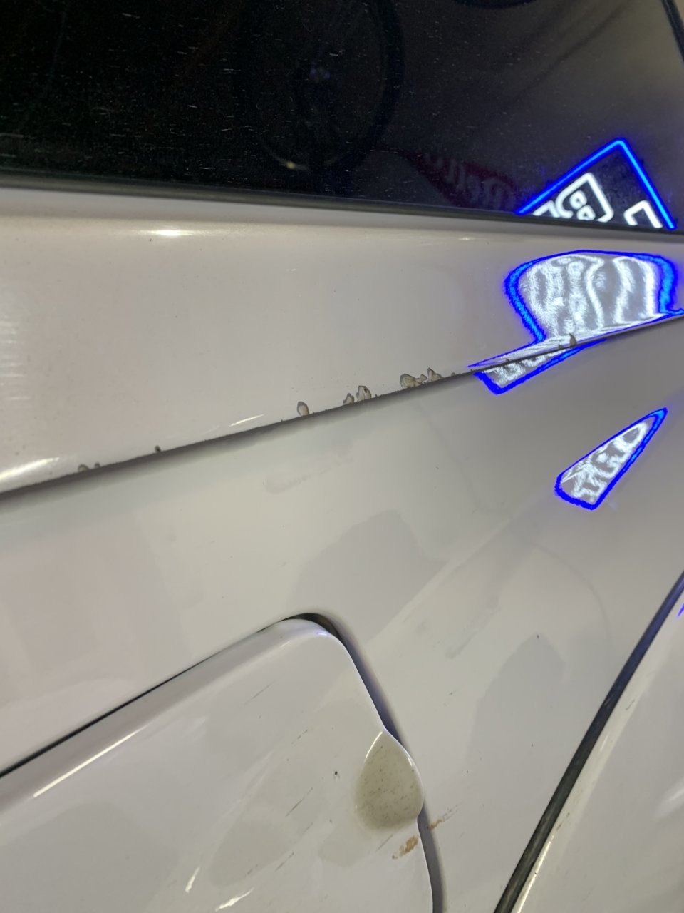

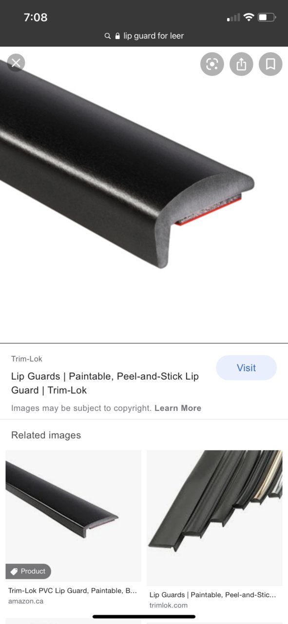

    Hey guys, first post here. Anyone have any recommendations on how to fix the chips on the bottom lip of a Leer fiberglass truck cap? The entire bottom lip looks like the spot shown in the picture. I was thinking of going the east route and getting some sort of white plastic edging but cannot find anything that is white in color. Any ideas where I could find something like that? The edging in the picture would be perfect if it were white. Any other ideas are appreciated. Thanks!24E64D0D-3E4D-4ECA-BDBE-C6F55B270CA9.jpg7C6066E8-0AF9-4625-8B84-DEC51C34E11C.jpg

    Those lip guards are paintable

    UPDATE: I bought the trim and spray painted to color match. Turned out awesome. Hope this helps anyone else with this same issue. Quick and easy fix.
