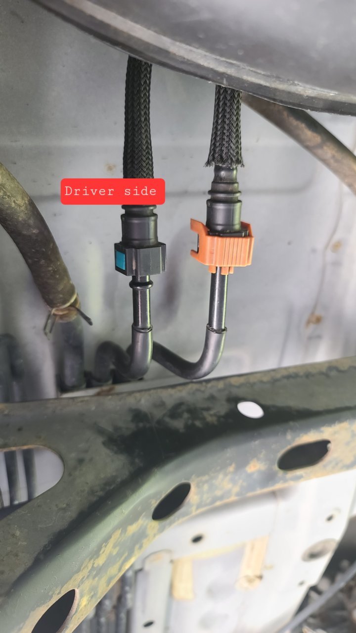

    My wife isn't here to crank it to test. I can use a test light and jump the control wire on the plug right? Do you know which wire that is on the plugs?
    Also, what would be the best way to test for fuel without a fuel pressure tester?

    Shoot a bit of carb cleaner down the intake and see if it trys to run on that, if it does then most likely you have good spark and we are missing fuel.
    About all you can do is take the line off here, put a piece of hose on the fitting on the frame, run it into a container, and see if fuel comes out when you crank on it.

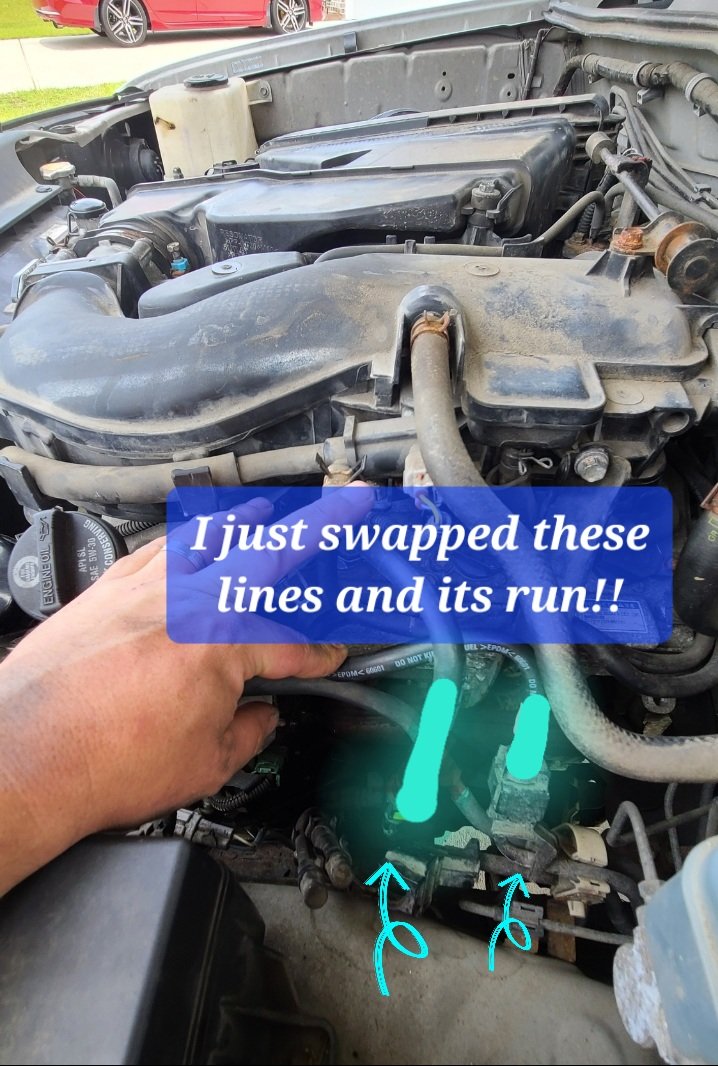

    Okay she started with starter fluid. Im wondering if the fuel pump hose routing in correct. I have it just like that unless theyre suppose to cross. When I disconnect the driver-side fitting fuel sprays everywhere

    I thought they were different sizes so that they couldn't be mixed up, do you have fuel at the line I showed above in the engine bay?

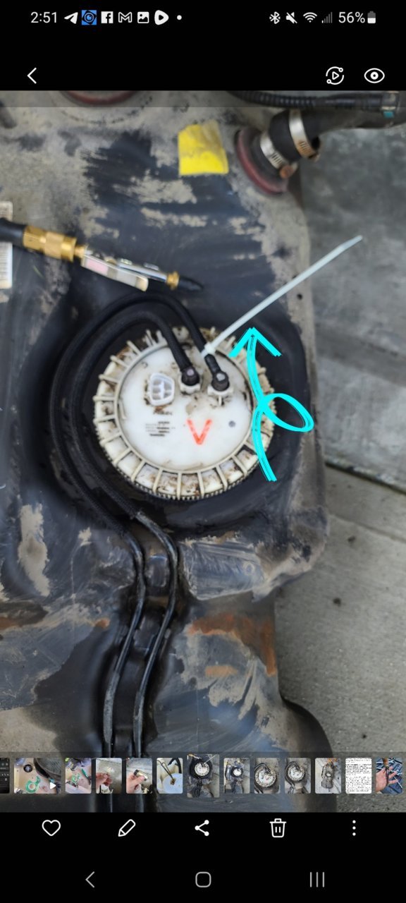

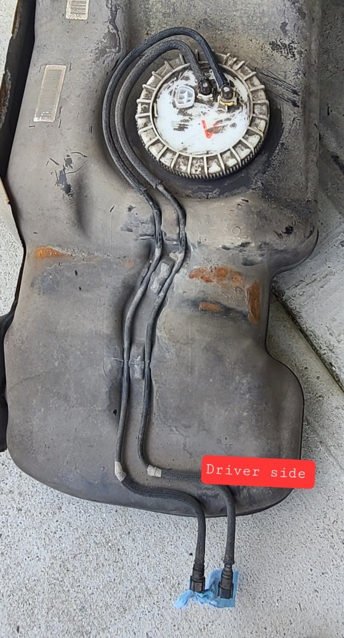

    Yes, I disconnected it and nothing came out. The pump is definitely priming. Looking at my pictures and then the tape marks on the hoses on the fuel tank, it seems I swapped the hoses in the wrong spot

    Got it! I swapped the front two lines and it runs!! Thank you so much!!

    Correct, the fittings under the truck have different line sizes but it's the same connection on the fuel pump cap. And apparently, the front has the same connections!!!!

    The sad part is I did zip-tie them lol.
    The lines are the same size on the fuel pump cap but under the truck connections are different. I couldn't get them to connect, so I think they have to be different.

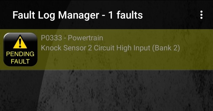

    Will do! Put everything back together and she runs good!!. CEL is on and this fault came up.

    Well crap, that likely means your critters were under the lower intake in the valley of the engine munching on the knock sensor wires as well.

    Let’s hope not, that’s a BIG job.
    The ECM will eventually set the timing to max retard.
    You’ll notice a difference, it won’t have near the power it should.

    Not a surprise if you had critter damage elsewhere.. they love those knock sensor wires

    I drove my truck around it's running just fine. It definitely has power. Is this something I can check on the ECM?
