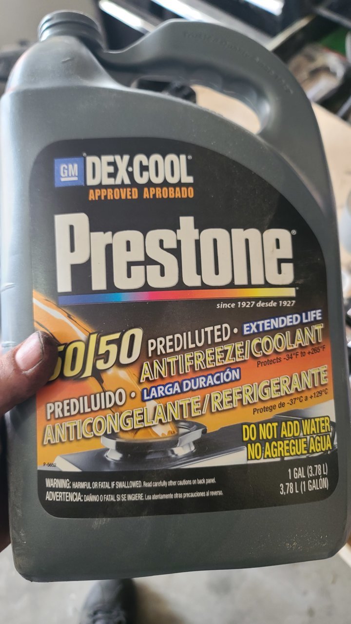

    I
    I filled it with Prestone dex cool, Do you think I should drain it and replace it with Toyota red?

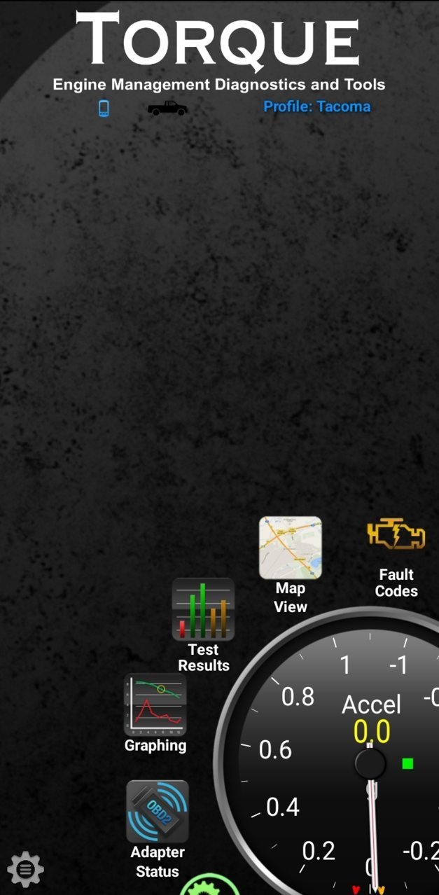

    Is this something my scanner will show in real-time? I'm guessing I would replace both cats if it's not a leak upstream?
  12. May 18, 2023 at 3:17 PM
    #252
    Dm93
    Dm93 Test Don't Guess
    Mar 3, 2015
    #150066
    13,653
    Texas
    2014 DC OR 6spd 4x4
    Predator tube steps, Ranch Hand grill guard, Magnaflow CatBack exhaust, Toyota tool box & bed mat, 2LO Module by @Up2NoGood, Rearview Compass/Temp Mirror, Tune by @JustDSM.
    If it can do graphing, yes you can pull up your upstream and downstream AFR/O2 sensors and graph them to see how the cats are performing.
  13. May 18, 2023 at 3:24 PM
    #253
    knayrb
    knayrb Well-Known Member
    Mar 3, 2010
    #32473
    2,224
    Bryan
    Somewhere in the square states
    2010 Dbl-Cab Off-Road
    Pure stock
    Toyota uses OAT coolant. See if that jug is that kind. Color doesn’t matter. There is no standard on coolant color.

    I have graphing on my scanner and ill see how they're performing. Should I even bother with aftermarket cats?
  15. May 18, 2023 at 3:29 PM
    #255
    warz
    warz [OP] Well-Known Member
    Oct 18, 2013
    #114726
    115
    michael
    I flushed it and l put in Zerex Asian Vehicle coolant.
