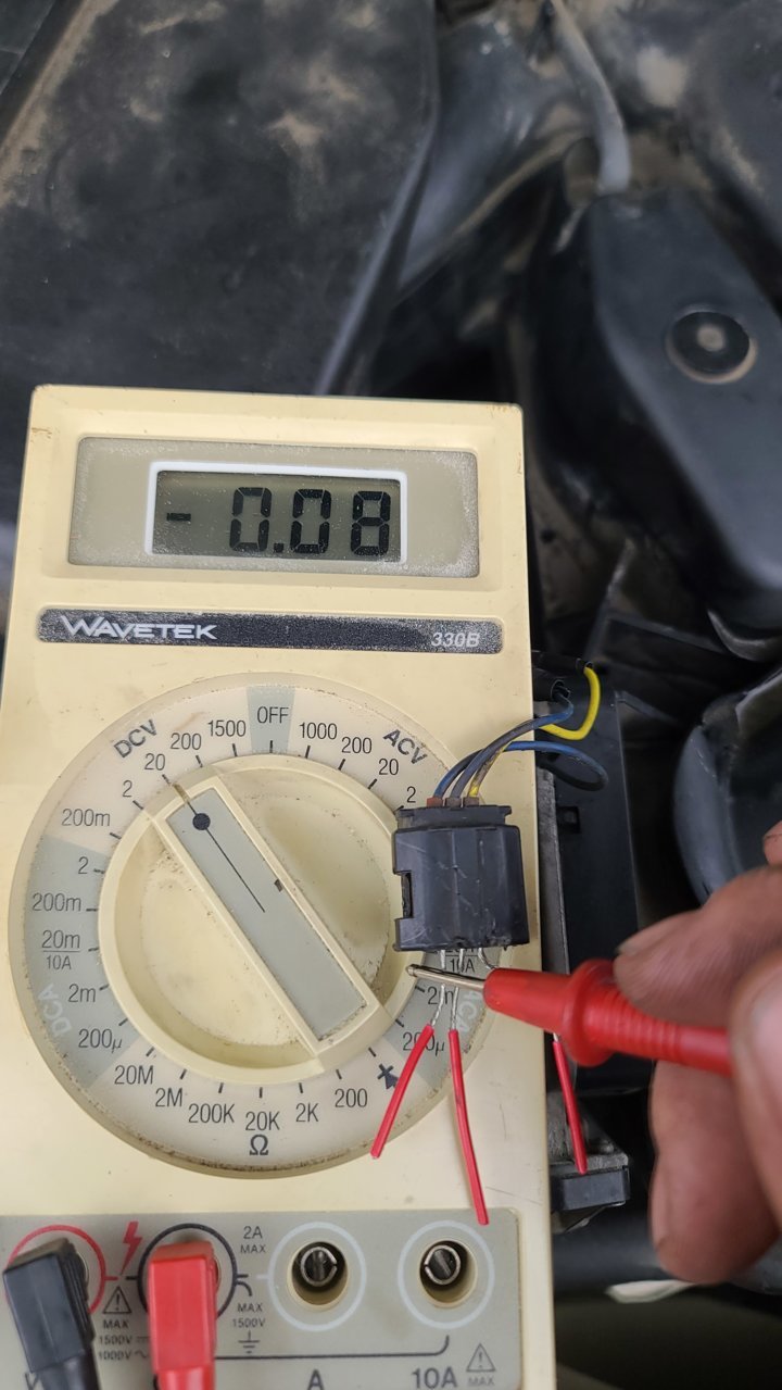

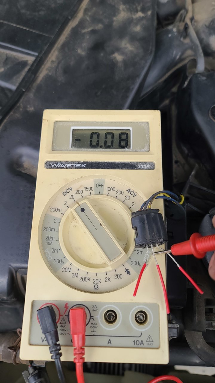

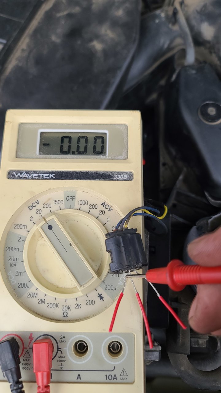

    Hello, The negative lead is on the neg of the battery. The first blue wire and the yellow are reading .08v on the 20 setting.(pictures attached)
  5. Apr 25, 2023 at 3:21 PM
    #25
    TnShooter
    TnShooter The TacomaWorld Stray
    Sep 2, 2010
    #42625
    21,208
    Deogee
    07' TRD Off-Road, Auto
    STOCK
    Your leads are reversed where you plug them in.
    That’s why you are seeing a (-) Negative voltage.
    It really doesn’t matter. You should still see about 5v on the blue wire.
    Whether it’s -5v or 5v,
    .08v isn’t correct, we need to focus on that issue.

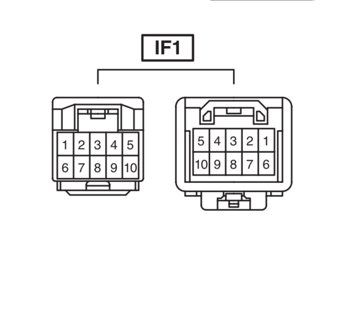

    5v is E4 pin# 23 of the ECM
    5v for the LH Cam Sensor is IF1 pin# 7
    The same 5v goes to the blue wire on the Throttle Body.
    You could check it. That would give you an idea of where to “start”.
    IF1 is kind up way up there in the dash. I’d go to the throttle body, then ECM, then IF1.

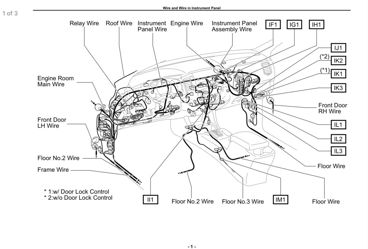

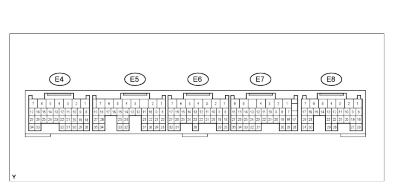

    Here is a pinout
    Dm93 likes this.

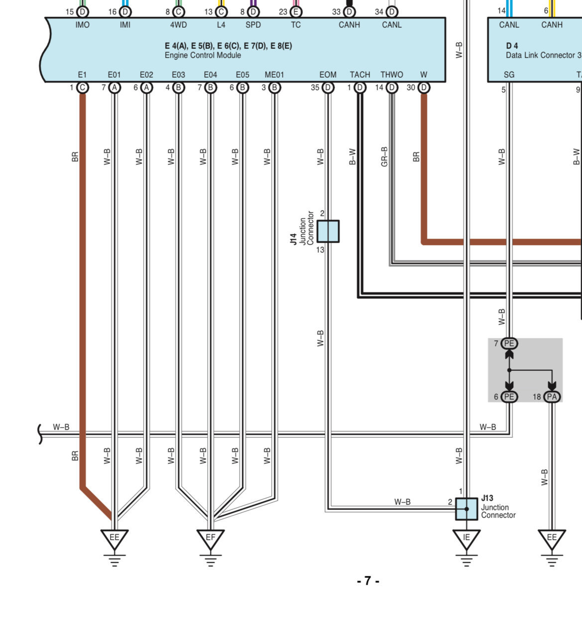

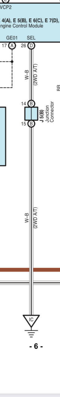

    The powers are list in the pinout.
    Toyota doesn’t tell you in the pinout exactly what pins are ground.

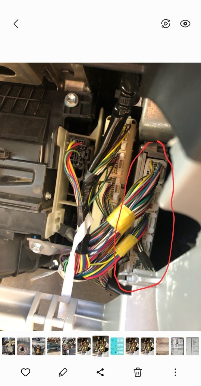

    I grabbed the obvious, listed below.E4704DC1-5711-4B7A-9356-6680005C69C0.jpgD91F2B8B-8070-4F6C-B96A-61CB3A61FEB6.jpg

    michael
    Please explain. Where is this located on the truck? Thanks again
  17. Apr 25, 2023 at 4:11 PM
    #37
    Dm93
    Dm93 Test Don't Guess
    Mar 3, 2015
    #150066
    13,617
    Texas
    2014 DC OR 6spd 4x4
    Predator tube steps, Ranch Hand grill guard, Magnaflow CatBack exhaust, Toyota tool box & bed mat, 2LO Module by @Up2NoGood, Rearview Compass/Temp Mirror, Tune by @JustDSM.
    PCM is behind the glovebox on the right side.

    Should I just check everyone? Should all of these connectors have power and ground? This might be a stupid question but where would connect the gator clip for ground? Normally I would attach it on the positive terminal on the battery but in too far away for that.
  19. Apr 25, 2023 at 4:24 PM
    #39
    TnShooter
    Sep 2, 2010
    #42625
    21,208
    Deogee
    STOCK
    In the picture above check grounds
    Top 1st plug (E4) pins #6 & 7 (White/black wire)
    2nd plug down (E5) Pins# 3, 4, 6, and 7 (White/black)
    3rd plug down (E6) Pin# 1 (Brown)
    4th down (E7) Pins# 26, 35 (white/black)
    Dm93 and warz[OP] like this.
