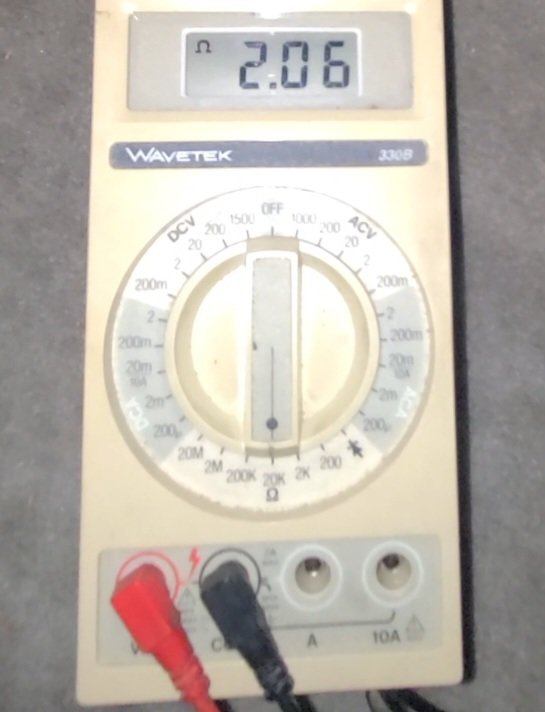

    2.06 0hms on the 20k setting.

    That's pretty low resistance, I think the next step would be to unplug connector IF1 and see if you get your 5v back at E4 Pin 23 at the PCM.

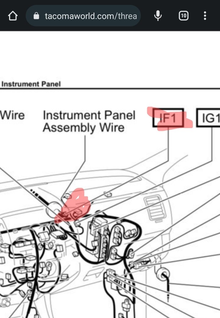

    Do I need to remove the dash to get to IF1. The diagram attached has pretty high up

    No the diagram is deceiving, it's actually wrapped up in the main wiring bundle below the PCM right before it goes through the firewall.

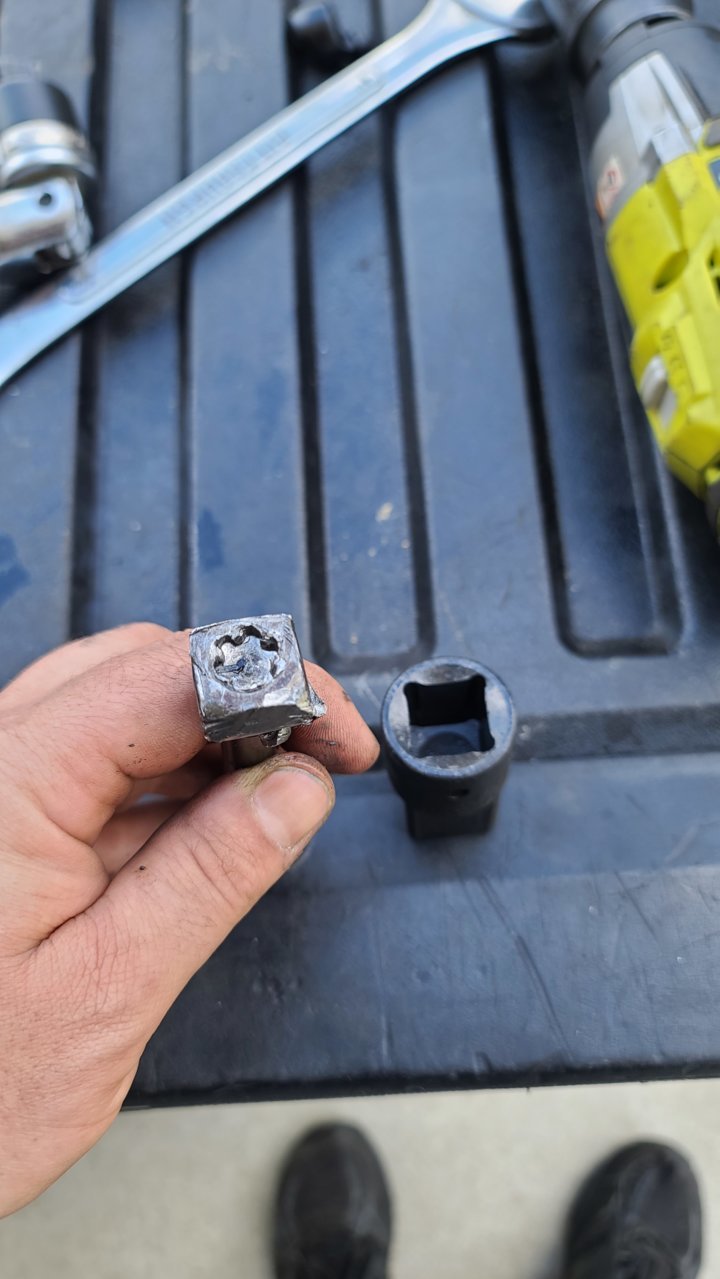

    I think both of you know your stuff. I wish I came on here a bit sooner and maybe I wouldn't have had to remove my truck bed resulting in 2 seized bolts that required me to change the heads from torx to square. Oh yeah, come to find out removing the bed doesn't expose the fuel pump at all that didn't need to get replaced in the first place!! Which leads to DM93 Slogan " Test don't guess"
