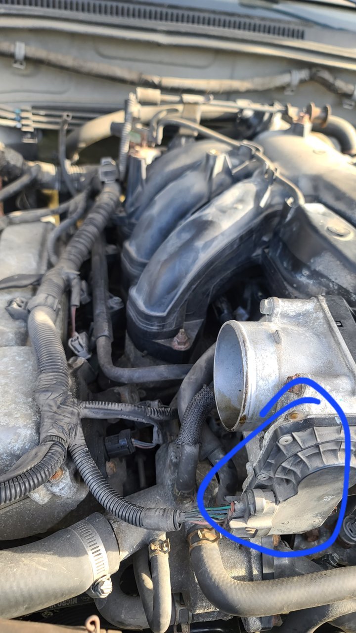

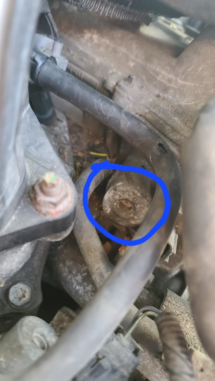

    It was not both my cam sensors it was the LH cam sensor and the Oil Control Valve that's right behind the LH cam sensor. I think some people call it the VVT solenoid ( Circled in blue)

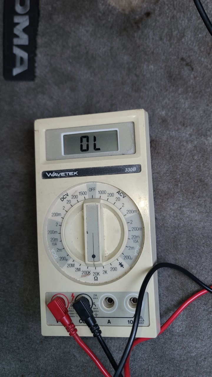

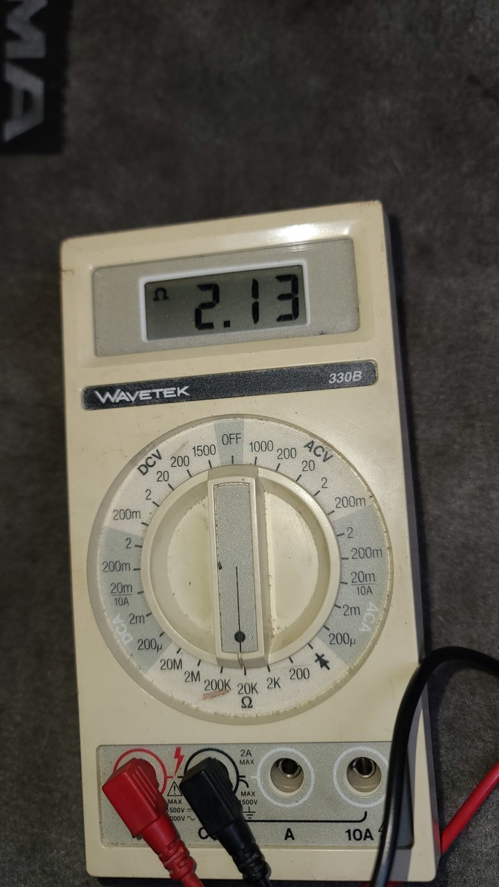

    With E4 unplugged and IF1 plugged in 2.13 ohms on pin #23 the 20k setting
    With E4 unplugged and IF1 unplugged I get OL on pin #23

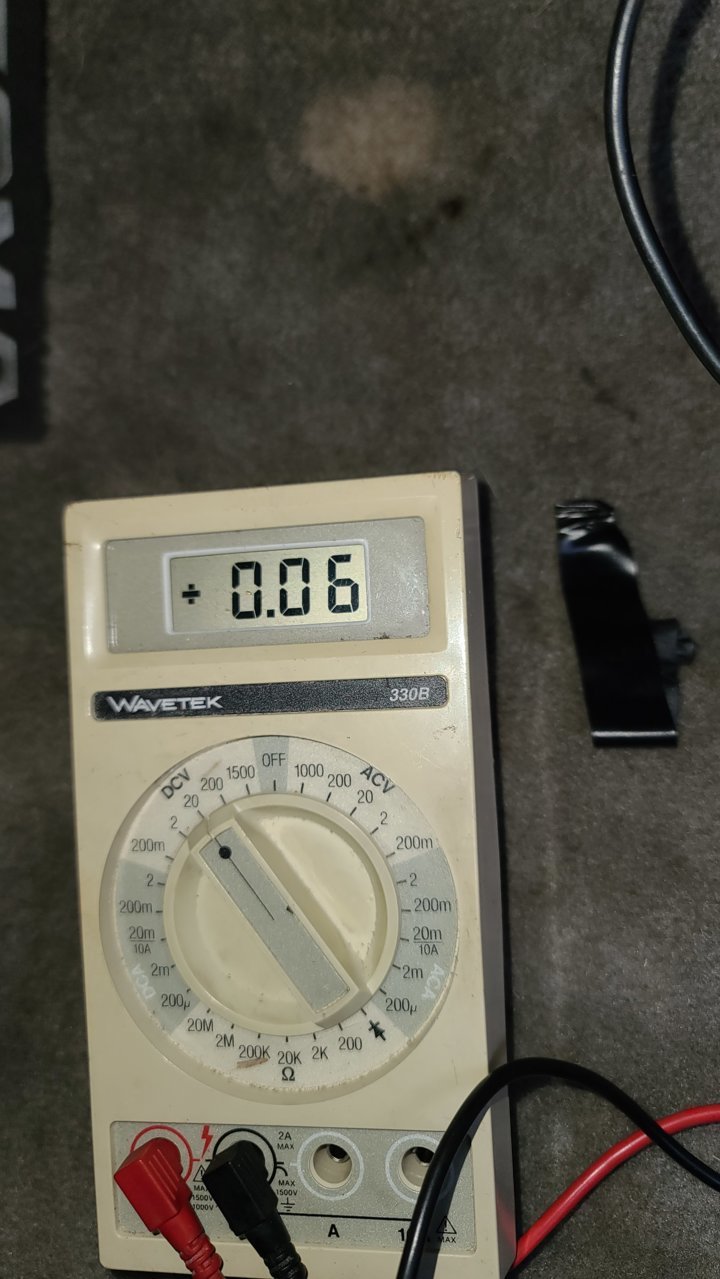

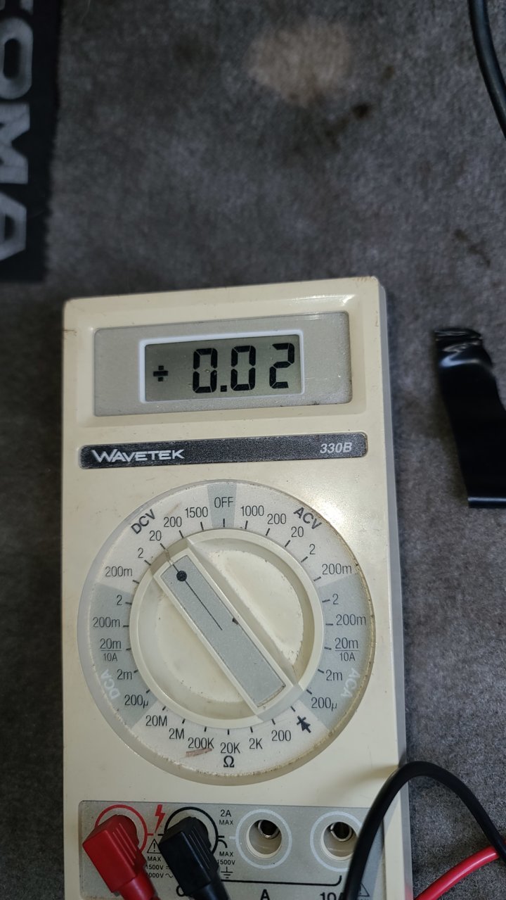

    With IF1 plugged in .02v on the 20 setting on my meter
    With IF1 unplugged I get nothing on the 20 setting on my meter
    With IF1 unplugged but E4 is plugged in .19 v on the 20 setting on my meter
    With IF1 plugged but E4 is plugged in .06v on the 20 setting on my meter

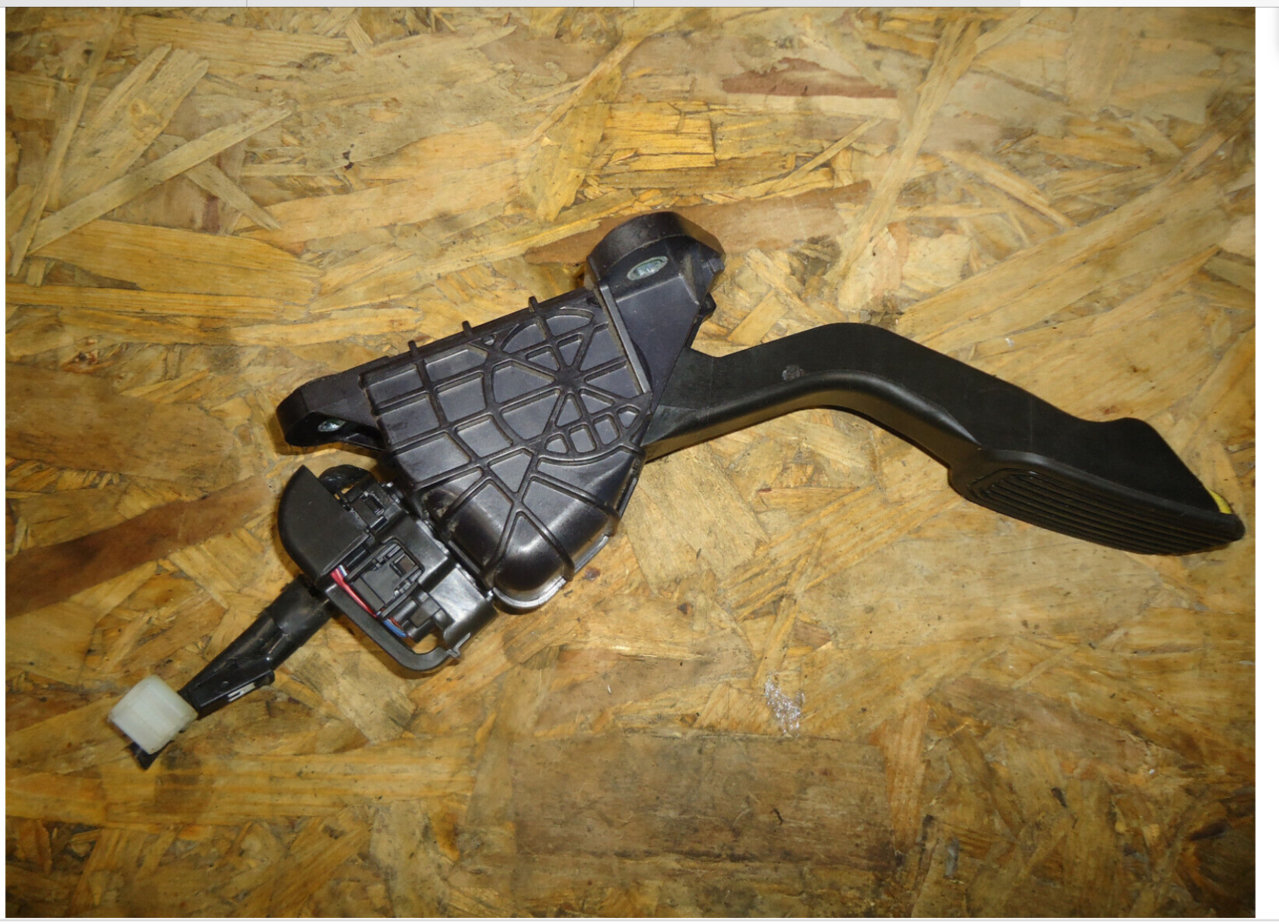

    Is this the APP sensor? Also, should my cam sensor still be unplugged? I plugged it back in after you had me check the 5v wire.

    And just to confirm, it is pin # 23
    That is the APP sensor. :thumbsup:
    Accelerator Pedal Position Sensor.

    No the APP sensor is the one on the acelerator pedal.
    With IF1 unplugged all the 5v sensors except the APP sensor should be isolated from the PCM so it shouldn't matter.

    Nope that's the throttle body.

    I never knew there was a sensor down there?
    And I was literally just down there looking at my pedal the other day.
    (Where Toyota cut it off).

    So it’s part of the pedal. Huh……well ok.

    Yep the APP sensor is on the acelerator pedal as it is on most drive by wire systems.
    Only the 03 and 04 with the early hybrid drive by wire system had it on the throttle body.

    IF1 Plugged in .03v
    IF1 unplugged nothing
