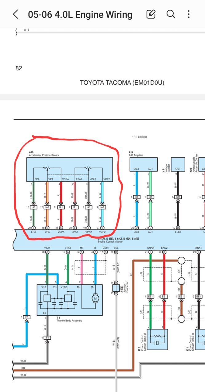

    I'm about to go over to my truck and do a couple experiments but if your powers and grounds are good but we have no 5v ref with everything unplugged it's looking like a failed PCM.
    No the wires go straight to the PCM, the VCP2 and VCPA wires are the 5v ref wires.

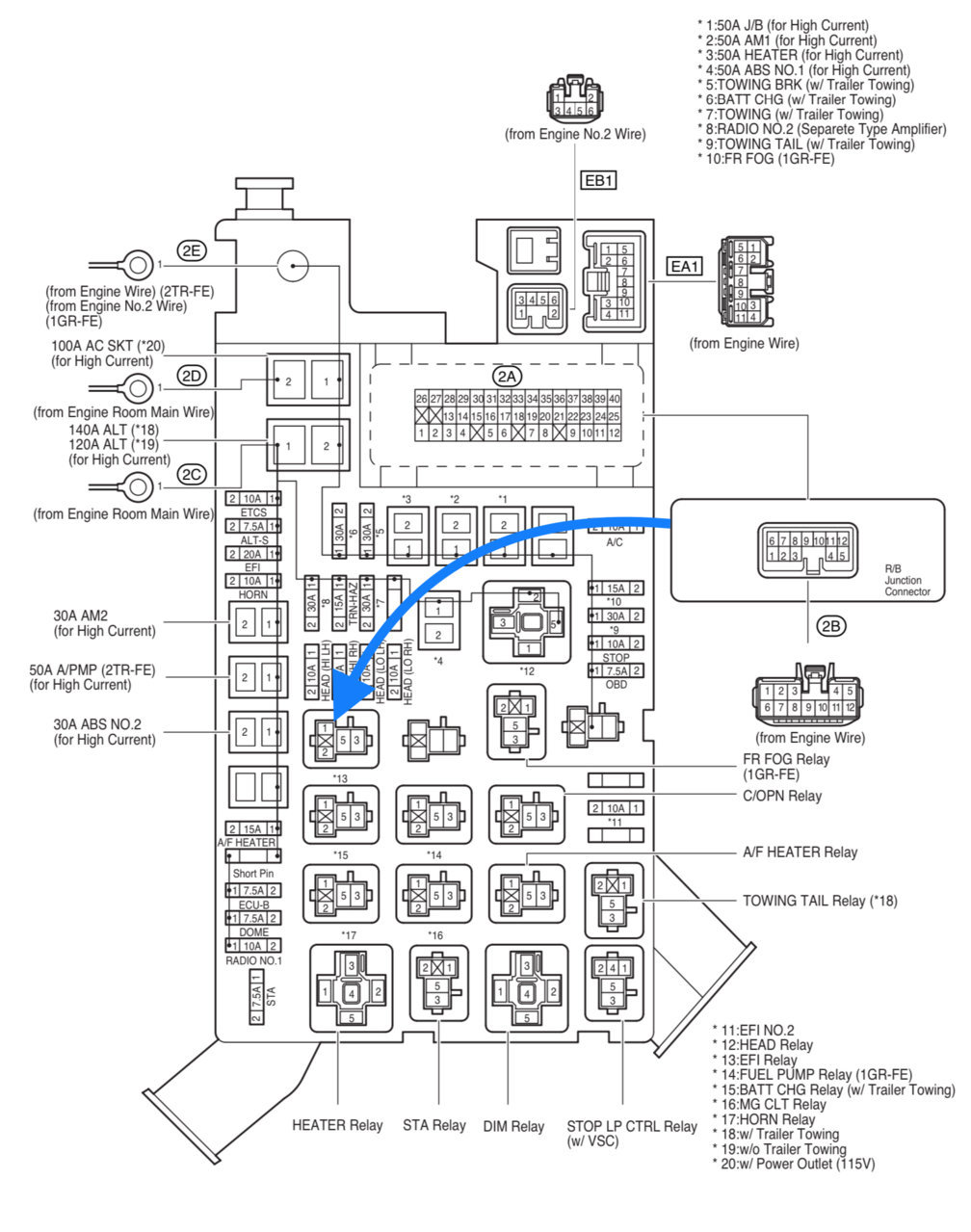

    Leme go get a pinout for the relay and I'll update in a few.

    Key ON
    12v to pins #5 & 1
    Ground at all times on #2
    warz[OP] and Dm93 like this.

    Ok at the EFI relay, key on.
    Pins 1 and 5 should have power and pins 2 and 3 should be ground.
    Test light to battery negative and pin 1
    Test light to battery positive and pin 2
    Test light to battery positive and pin 3
    Test light to battery negative and pin 5
    SR-71A, warz[OP] and TnShooter like this.

    OP, be sure to carefully read above DM93 pictures.
    Make sure your leads are on the correct battery terminal. 2 of the test are from the opposite terminal.
    Let us know what you find.:thumbsup:

    1 and 5 have power
    2 and 3 have ground.
    That all checks out good

    Swap the relay with the horn relay, plug everything in, and see what happens.

    Check engine light is now on. It's cranks but still doesn't start

    Ok finally some progress, so the EFI relay was bad. I bet your horn doesn't work now.
    Do you have 5v at the PC E4 Pin 23 (Blue) now?
