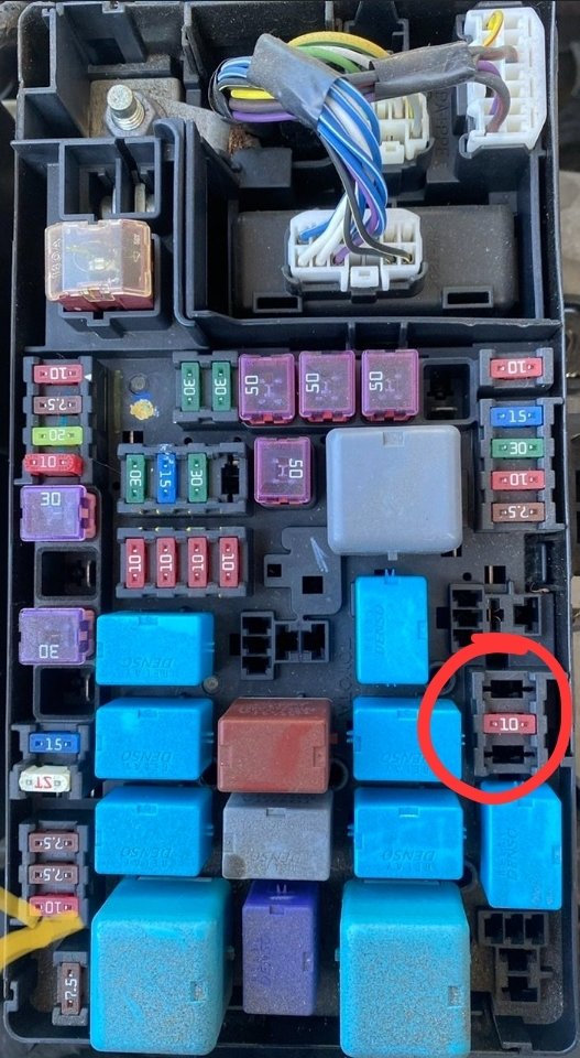

    Plus I noticed EFI 10a fuse still didnt have power when I removed the EFI relay. I didnt check it after I did the swap but I don't think that would change anything.

    If it was the 10A EFI No.2 it should have had power.
    The relay supplies power to that fuse. But it still won’t hurt to check.

    That fuse won't have power with the relay removed, the relay powers it but it should have power with the relay plugged in and key on.

    Great thread with lots of information, I have the same crank no start issue.I do not have any evidence of rodent damage.
    I have learned that if I pull that 10 amp fuse from the EFI and replace it, even with the same fuse as it is not blown the truck will start.
    Sometimes it will start for three or four days and sometimes it will only start once.
    Guessing that by pulling the fuse it is resetting something? but I do not know what it is resetting.
    Don't know if this is helpful information but seems like you have ended up at the same spot I am at with the 10 amp EFI fuse.

    I am not sure his problem is the fuse.
    He never had power to the fuse until he swapped relays.
    That fuse is powered by the relay. While your and OP problem is similar, I’m not sure they are the same problem.

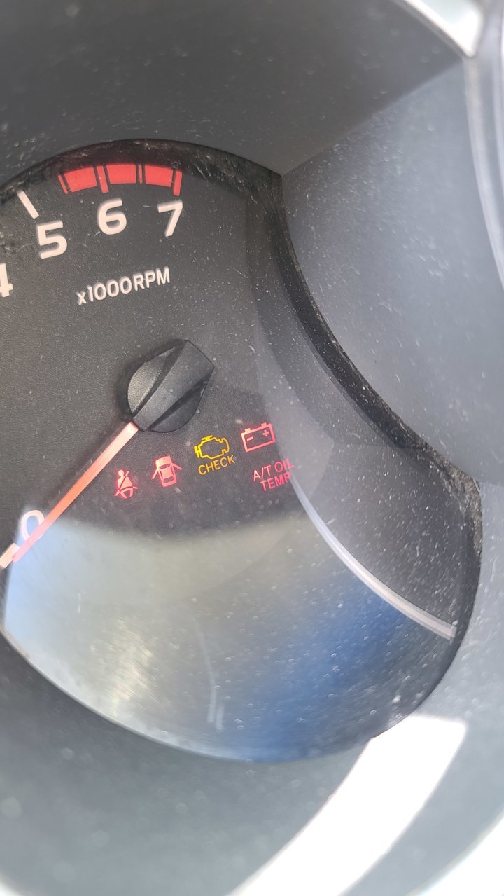

    No, I now hear my fuel pump prime. Dash also has A/T oil temp with the key on. Not sure if that is normal

    I think that's normal on automatic models, does the tach move while cranking?
