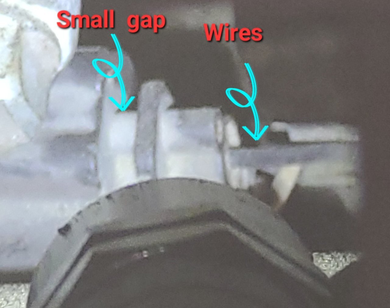

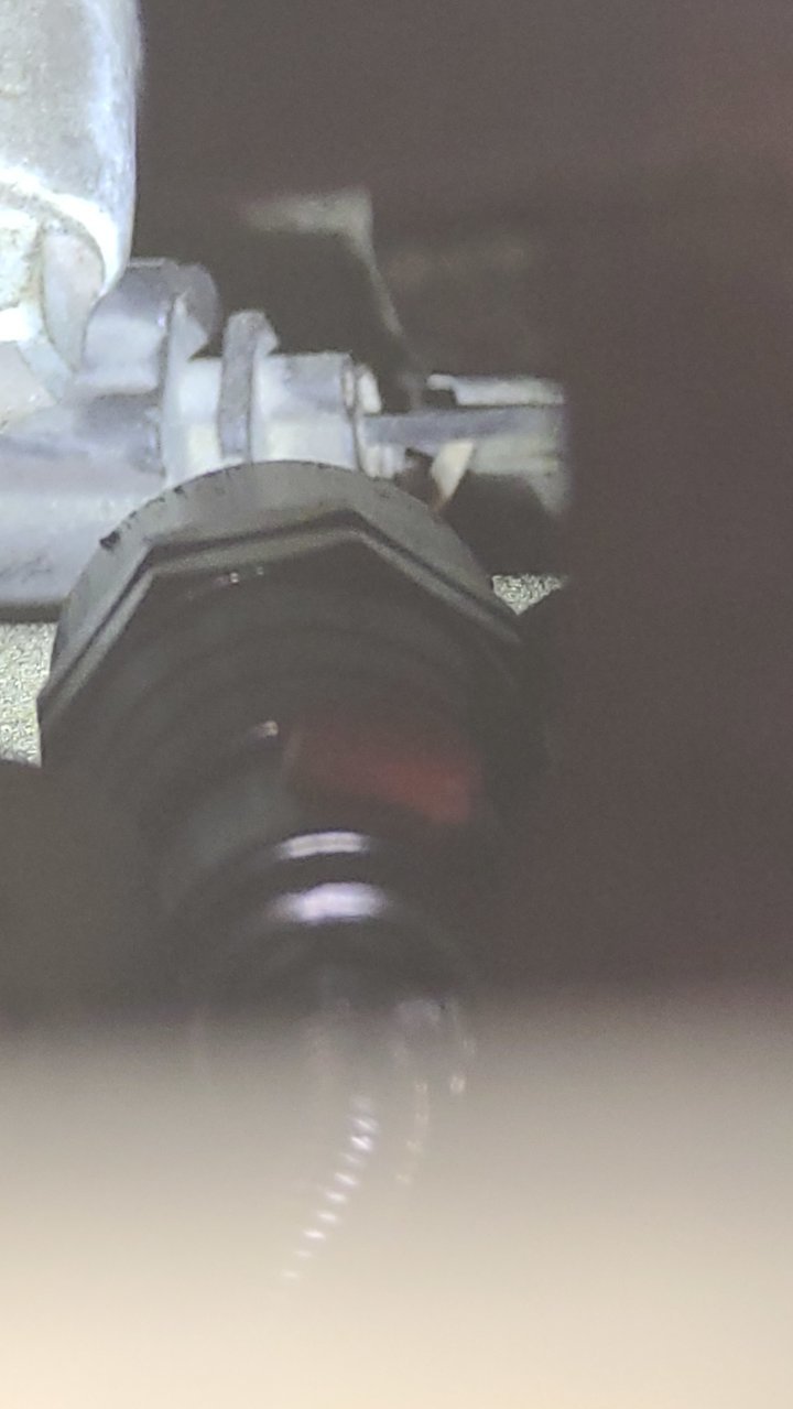

    You can see a small gap between the connector but I put a longer screwdriver down and it doesn't move either way. It runs up with the alternator harness into the fuse box. Is it connected to a relay?

    Predator tube steps, Ranch Hand grill guard, Magnaflow CatBack exhaust, Toyota tool box & bed mat, 2LO Module by @Up2NoGood, Rearview Compass/Temp Mirror, Tune by @JustDSM.
    Can't really see anything in the picture but the crank sensor wires go straight to the PCM.
    I was more worried about it being pinched somewhere.
    I'm kinda thinking the relay may have been the original problem and we may now be dealing with a problem that was "built in" from changing parts.

    I don't see any pinched wires, I can follow the harness that runs with the alternator. Hopefully the scanner will tell us more

    It’s hard to see how much of a gap is there.
    But it “kind of” looks excessive. Hard to tell though.

    I remember seeing somewhere in the FSM that the CPS had to be flush.
    You might get away with a small gap. But the closer the better.
    I may try to crawl under mine if I get a chance. I never looked, is it easier to see from the top or bottom? I have to head out to pick my grandfather up from the ER, he fell and busted his head pretty good. If I get a chance, I’ll try to take a look at mine later tonight.

    Is the eyelet for the hold down bolt flush against the block? We need a better picture
    crank sensors have an o-ring that will always hang up going into the hole, I use a little lube to help it slip in and rotate while pushing
    But, are we talking about the sensor possibly not seating against the block? Or just wondering if the connector is fully seated?

    Damn, dude! I hope he's okay! Don't worry about it, spend time with the fam. If you stand on the side standing in line with the fuse box, I'm pretty sure you can follow the alternator harness down to the crank sensor. There's a small window and you can see the clip. Im not sure that's a gap, it's kinda to close to the wires and it clip should be further up.

    I did use oil while inserting it but it was tight. I did end up pushing it as far as a could but relied on Tightening the bolt to draw it in. It seemed to be flush but they're could be a gap. I wonder if I could get away with just removing the compressor this time and not removing the fan assembly and the alternator.....
