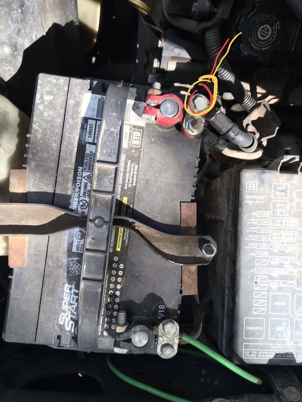

    This wire was a little loose. Tighten her up, hopefully that’ll do-er. I don’t expect so but that would be nice!

    I'd tighten that battery clamp/holder down as well, looks like the battery is sliding a bit...don't want it to come off the tray and fall into the fan shroud or something

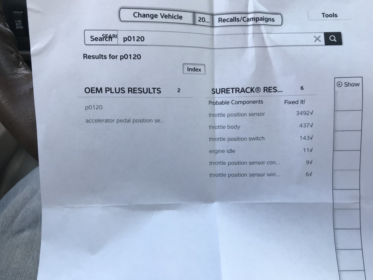

    Went to o’reilly to check for error codes.
    Got this printout.
    I wanted to see what you, the actual experts, have to say about it before I spend $65 on a new throttle position sensor.
