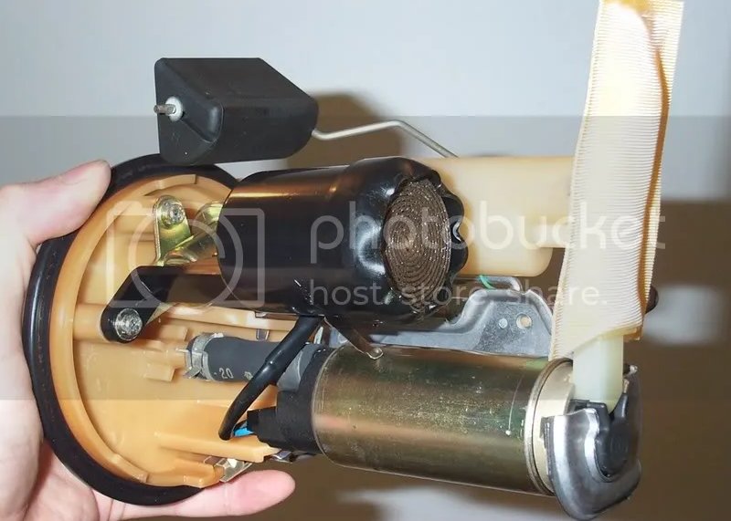

    If you have an excellent digital ammeter, you can read current to the pump. A screenshot will show dips (burned armature). Pumps in-tank use gas to keep cool, so always good to fill up before your get to 1/3 tank to keep the pump submerged. Rusty tanks, intake socks full of crud are normally a freeway issue.
    Until you get the pressure readings, you're just guessing at the issue.
    The photo is random (Camry?) but gives the idea of what I call a sock. I just meant to keep big chunks of crud out of the pump.
