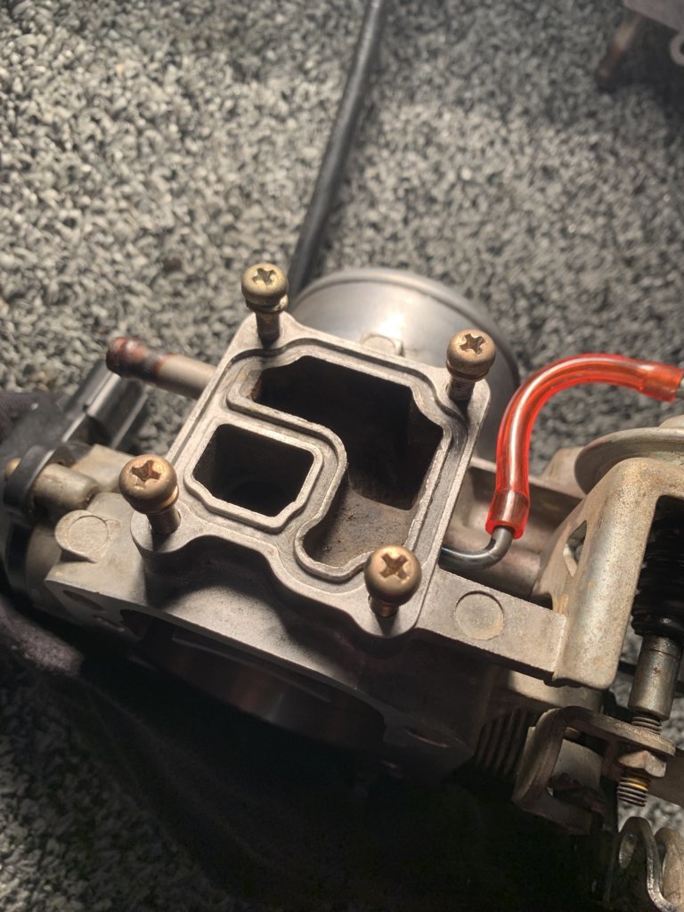

    Common answers from previous forums say it should be either the IAC or a fuel issue. I have no CEL so that's kind of sad.
    With the truck being able to rev and accelerate, that should rule out a fuel issue, right? It turns on, goes to 300 rpms or so, runs a bit rough, and then dies.
    It's not an issue with the MAF sensor, I've tried OEM, and 2 cheapo sensors that work in another truck flawlessly.
    I'm thinking it's an IAC due to having a similar issue on the 4th of July. Truck is doing the same thing but once revved, it would stay on.
    I'm at 165k so maybe it's time for a new IAC?
    https://imgur.com/a/7beUFZu

    The IAC would cause a high or rough idle- not for the engine to die.
    Someone like @TnShooter might be able to give better trouble shooting steps, but it'd be looking at the open circuit relay or maybe a crank sensor.

    Need a year and motor size... later tacomas have a drive by wire throttle and if she is of that vintage usually a cleaning of the throttle body cures that. Looking at the throttle for a build up of gunk couldnt hurt either. The Idle air control valve just bypasses the throttle plate with metered air. As a test you could adjust your throttle cable, if so equiped, to just crack the throttle and see is she starts and runs normally but at a higher idle.

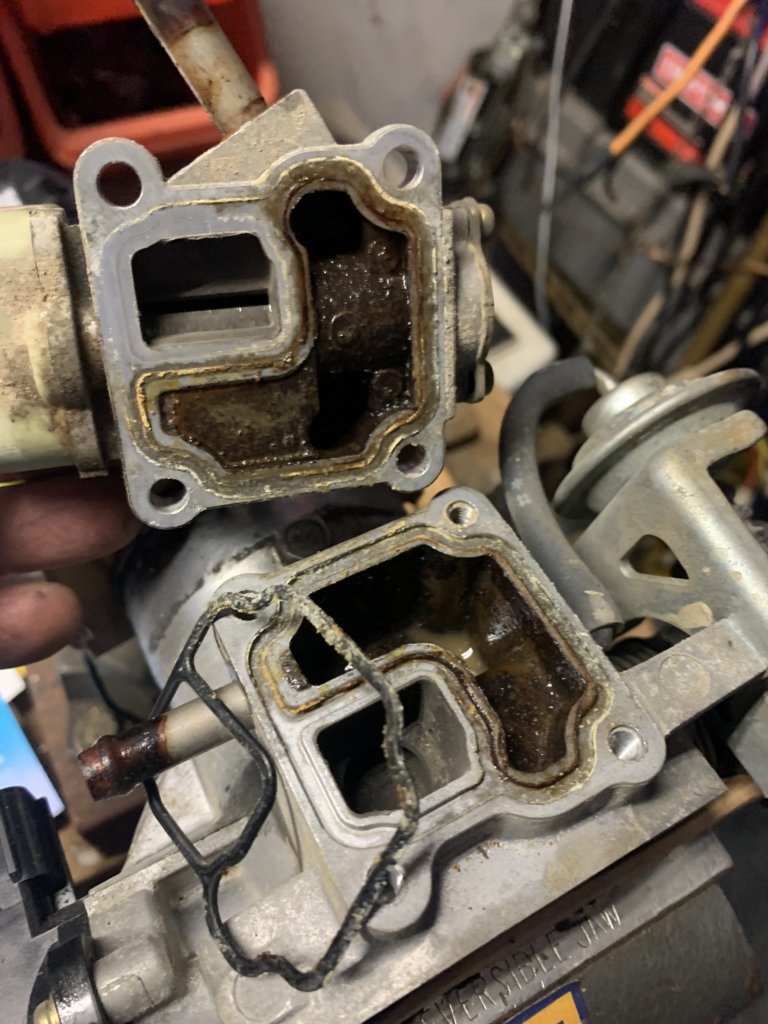

    this was my IAC 212k before I took advice here to clean

    Damn that's gross.
    I'm finally going to work on my truck tomorrow. Thankfully I have a friend with the same exact truck so I can pretty much change every part that could be the failure. I'm hoping it's the Throttle positioning sensor because it's easy to fix. Most likely maybe an IAC or a fuel issue, I hope.

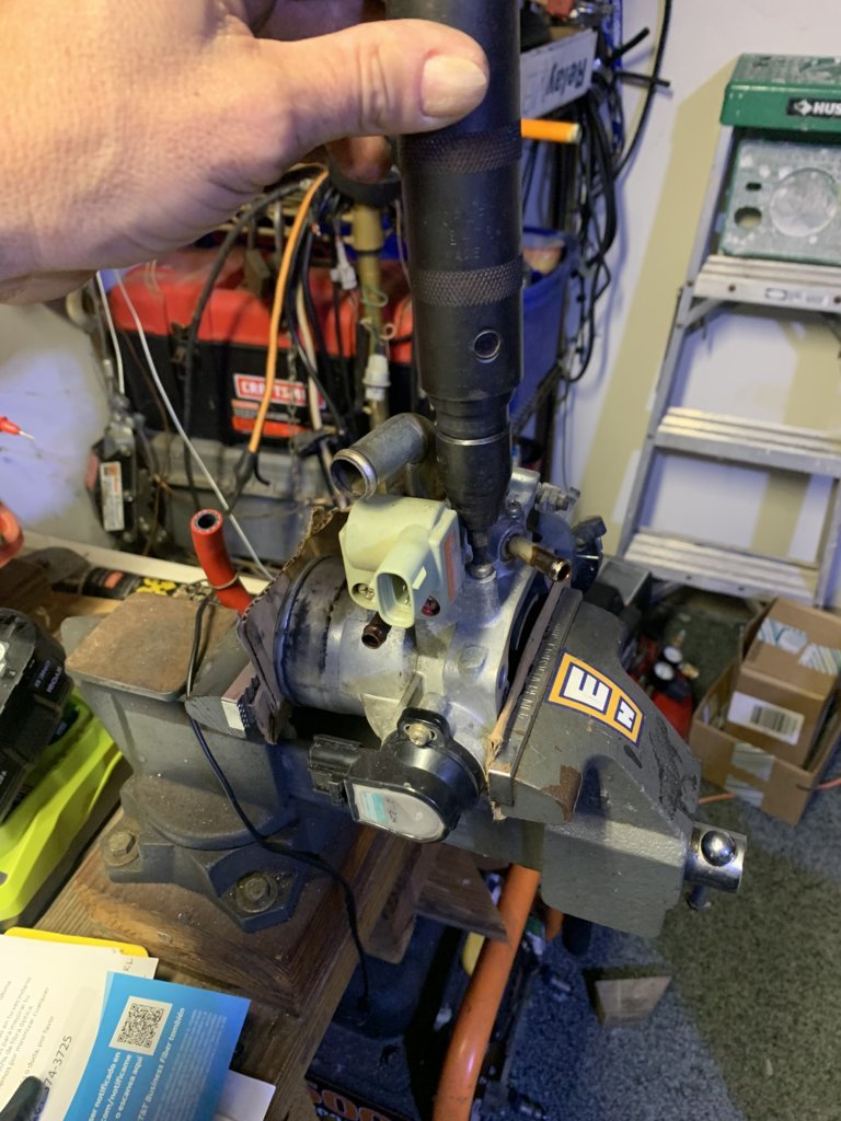

    I’m not sure about 3.4L IAC
    But
    The 4 Phillips head screws that mount the IAC are known to strip when trying to take off
    Once TB off
    -use a HIGH quality screwdriver
    Or
    -manual hand impact
    Makes life easier!!!

    The reason they strip out is because theyre not philips. They're JIS screws or japanese industry standard screws. Another location is on the MAF sensor. I know this because I had to drill them out. I've considered buying a set but I'd rather drill out and replace rather than deal with those gimmicky screws
    Thanks for the comment tho. What'd you clean the whole process with, just throttle body cleaner and Q tips?

    i bought 2 cans brake clean
    needed 3.5 cans
    (i later learned that $17 gallon of Acetone(another member here told me) from home depot/lowes works the same....just not pressurized
    old tooth brush(s) and awl (for the gasket ridge)
