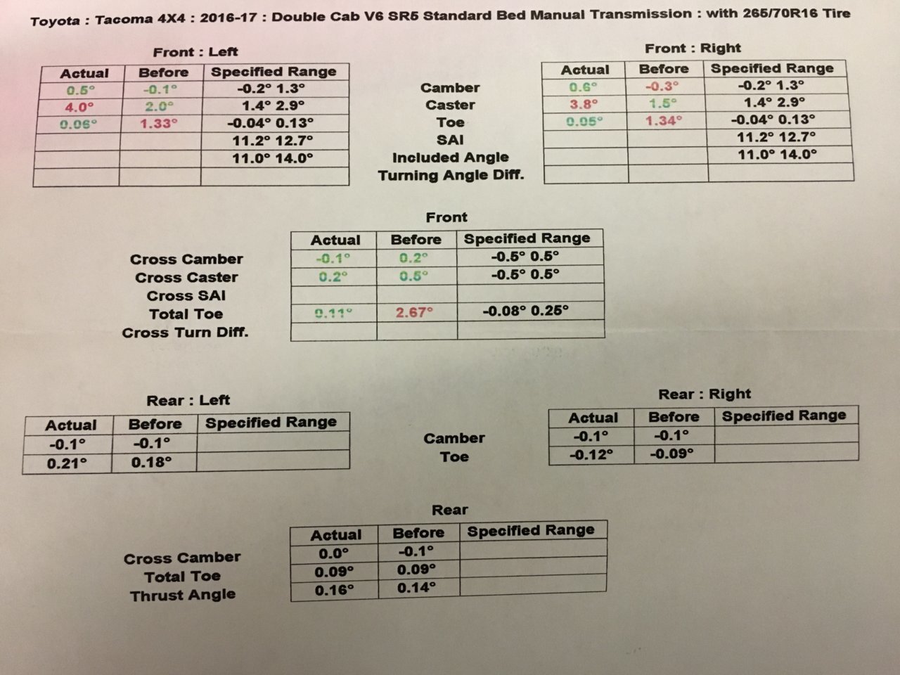

    Can you post the results of the alignment? Things like positive camber can aggravate the road ruts, pulling the truck in either direction. And, as has been said here previously, but bears repeating, being "in spec" does not mean you have a proper alignment. There's a range of "spec" and if you have one side at one end of "spec" and the other side at the opposite end of the range, well, it's surely "in spec" but just as surely not aligned correctly. And, yes, you do have to ride the alignment jockeys in order to get it right, but it also helps to know what you're talking about or they'll just laugh at you and do what they want anyway.

    Here is my print out. One thing to caveat: The numbers the tech showed me on screen before he started any adjustments were all green (toes were much closer to zero). So I'm not sure what he did between then and the "Before" numbers on this.

    Your front toe was way off before, l don’t know if it was that way when you brought it in or he remeasured after adjusting the camber and caster.
    If toe was that far off it would cause the issue you had/have.
    The other thing I notice is you rear toe is off, looks like the axle is cocked.
    I’m not sure I would trust those numbers.
    I would get it rechecked.

    Ya, hopefully the dealer will have a look at it as well. If I go through with the suspension upgrades, I'll go get it realigned.
