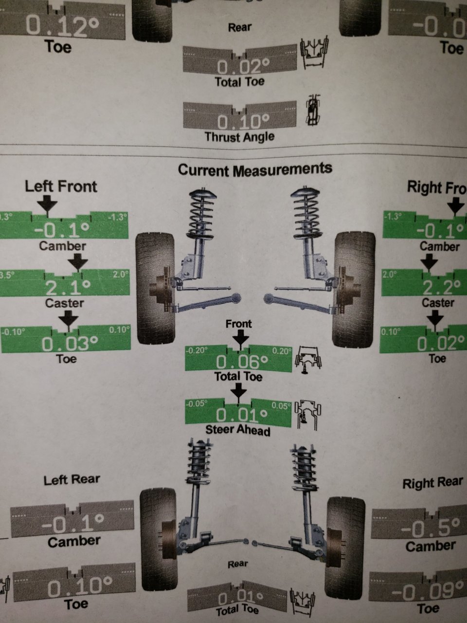

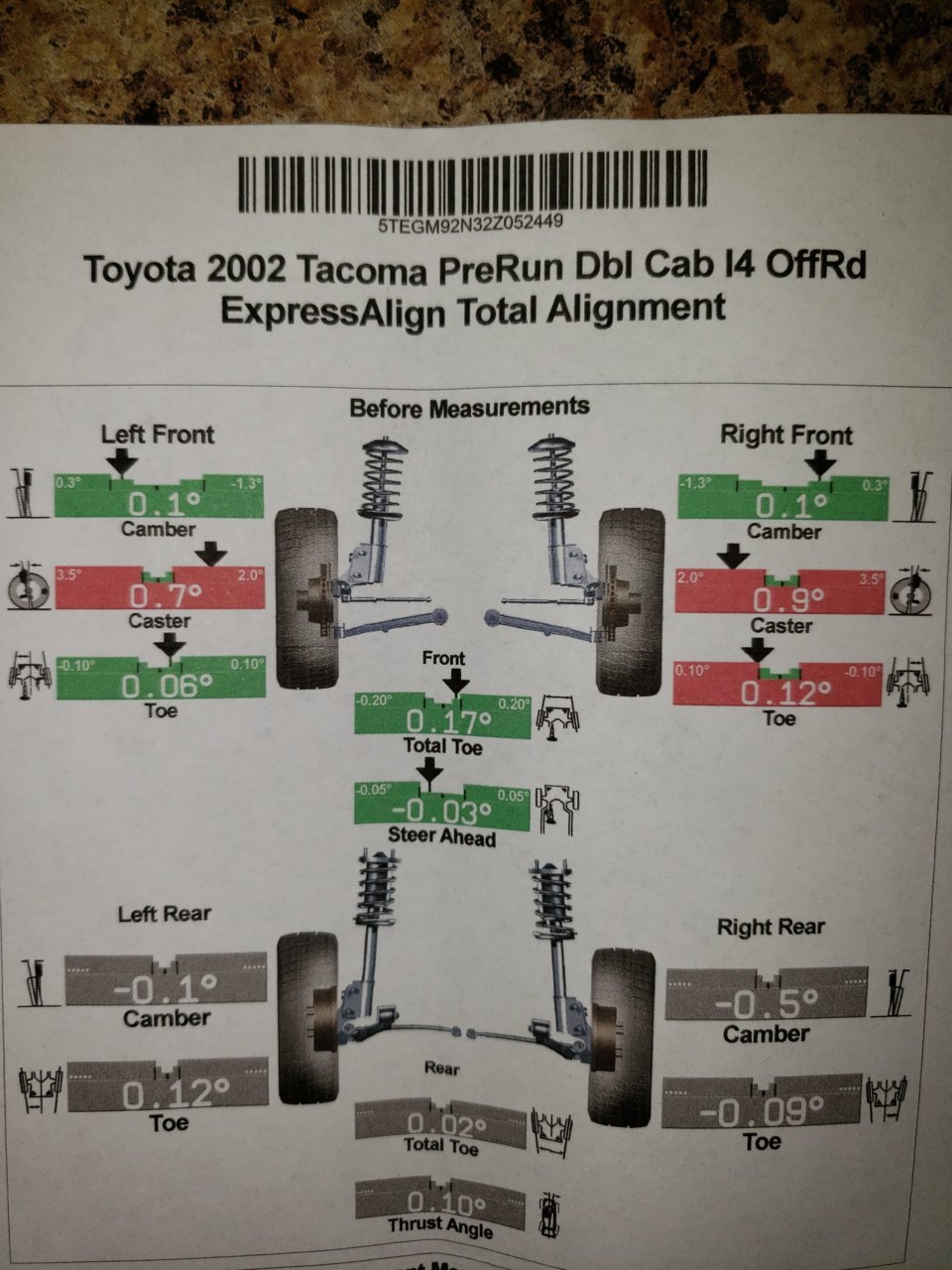

    I know this alignment spec is on my 02 DC Pre Runner but I had issues with bump steer after having Discount Tire do my alignment 2 years ago
    Bump steer was so bad that any road imperfections like degraded road conditions ... bumps , road patches or even man hole covers would cause the truck to violently move to the right or left sometimes out of my lane
    I had Firestone do my alignment a couple months ago and now it's much better and no more bump steer . I was told by the Firestone alignment tech that Discount tire didn't account for the suspension lift when they aligned it
    Before (notice camber /caster readings)
    After ......

    Thanks, it's a good reference. Your after numbers are quite similar to what I had when the tech first hooked up the machine.
