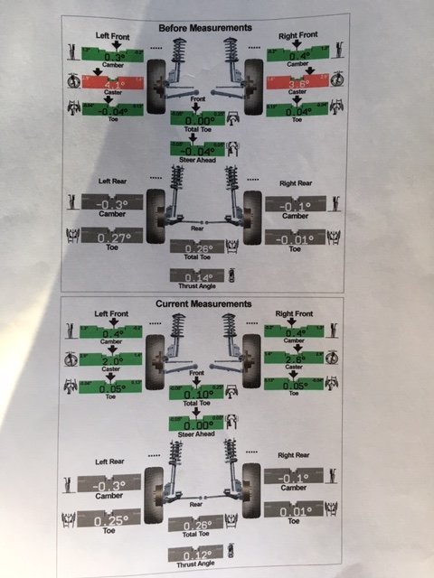

    Finally remembered to grab this:

    Only thing I see is driver's side caster is low. Surprised you don't have a pull to the side with lower caster. If cross caster is too much it does 'weird' things to camber and toe when you turn.
    I'd try for 2.8 on each side.
    Otherwise, it's a good alignment
