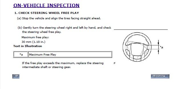

    On a straight, flat road, grab the wheel and jiggle it back and forth. I can do this a fair amount, and not actually be moving my tires, still goes straight. If I moved the wheel by the same amount in my fj, I'd be swerving back and forth. There's play somewhere, how much is normal, I'm not sure. I'm all stock.
