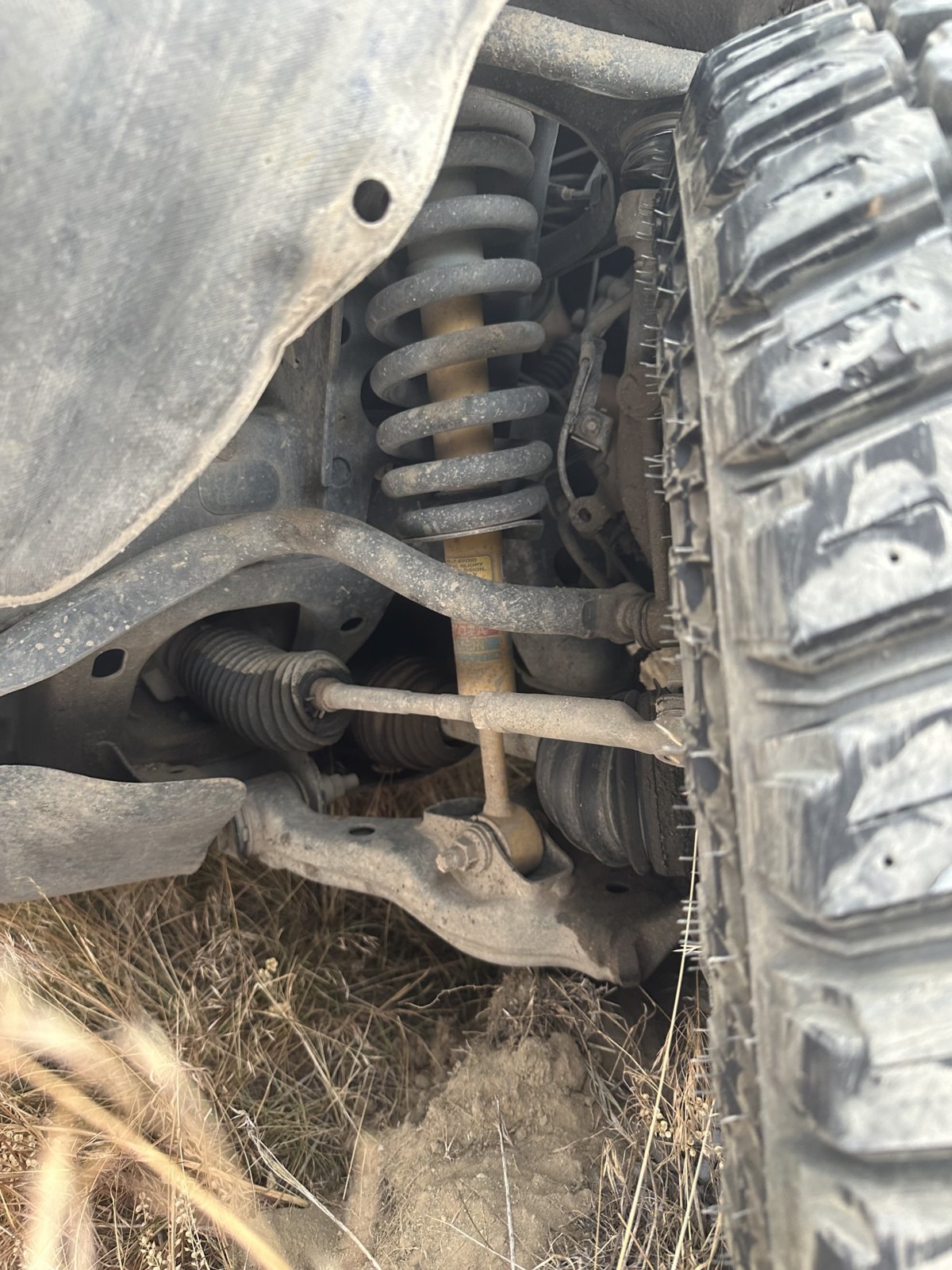

    I have the option to buy this truck for a great deal! I think? It’s a 2011 trd off road 4x4 190000 miles. It was in a collision. Hit the driver front panel and made the front tire go sideways. I think the upper and lower control arms are damaged. Most likely tie rod and ball joints and front axel? Nothing leaking after accident. The front bumper and headlight were damage gas well. Would you buy this truck? What concerns would you have?
    I am just planning iron making it an off-road hunting truck. Thanks for any input

    Might need a full rack and pinion, the boot looks full of ps fluid

    Add the price of a spindle to the list.
    The spindles have been known to bend if you wheel it hard.
    You may not need one, but I always like to “prepare” for the worst.

    I see a possibly bent knuckle/spindle from the collision. The rest seem to be from wear/neglect: leaking steering rack, torn tie rod end boot, missing inner fender splash guards, torn CV axle boots, and collapsed lower shock bushing. The frame on this 12 year-old truck looks rust-free! $1800 is a no-brainer!

    For that price you can’t lose. Worst case you part it out. Look for one that was rear ended or totaled anywhere but the left front and buy everything you need off that truck. Even if the frame is a little tweaked it won’t matter for an off-road rig. The 3 wheels that are good are worth half of what he is asking.

    LCA
    Spindle
    CV Axle
    Steering rack
    Might as well replace the hub, too, since you're there.
    It's a lot to replace, but for the price you're offered, it's a great setup.
