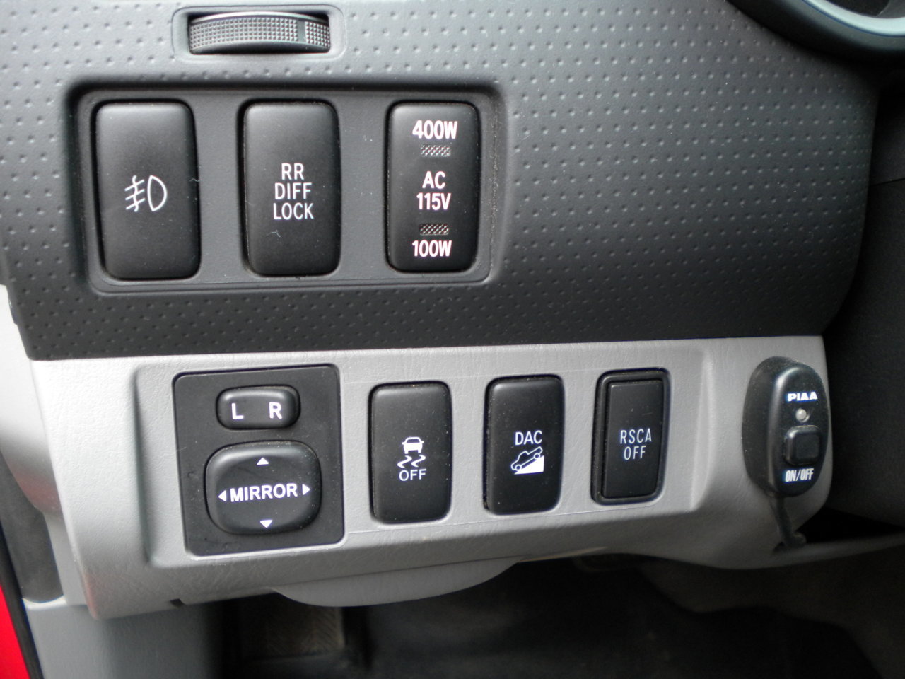

    2007 Offroad DCSB AT- VSC,TRAC,HAC, & DAC
    Icon Stage 8, ECGS Bushing, Timbren ubolt flip, Crown extended brake lines, Overland Custom Design sway bar links, rear differential breather extension, oil filter drain hose, a/c drain hose extension & reroute, front windows tint, Cat Security, XPEL headlight/fog & grill protection, OEM block heater, RCBS illuminated 4X4 switch, Weathertech mats, Wet Okole seat covers, Sherpa Grand Teton/Crows Nest, Baja Designs S8 light bar, Diode Dynamics SS3 Pro fog lights, Piaa driving lights, Method 305 NV Double Black, 275/70/17 Toyo R/T Trail.
    If you were actually using DAC you'd be off road on a steep incline in 4Low (with the tranny shifted into low gear) and you wouldn't have your foot on the brake... DAC does the braking. As far as the truck downshifting on a hill that's exactly what you want it to do.... it's called engine braking.
    My 07 has DAC...
  20. Sep 25, 2022 at 9:09 AM
    #20
    nd4spdbh
    nd4spdbh Well-Known Member
    Oct 7, 2013
    #114055
    14,603
    SoCal
    13 DCSB TRD OR v6 Auto
    I should of clarified, 09+ standard on TRD OR 4x4's. 05-08 TRD OR 4x4 was optional with the VSC package (a rare option btw) which it looks like you have.
