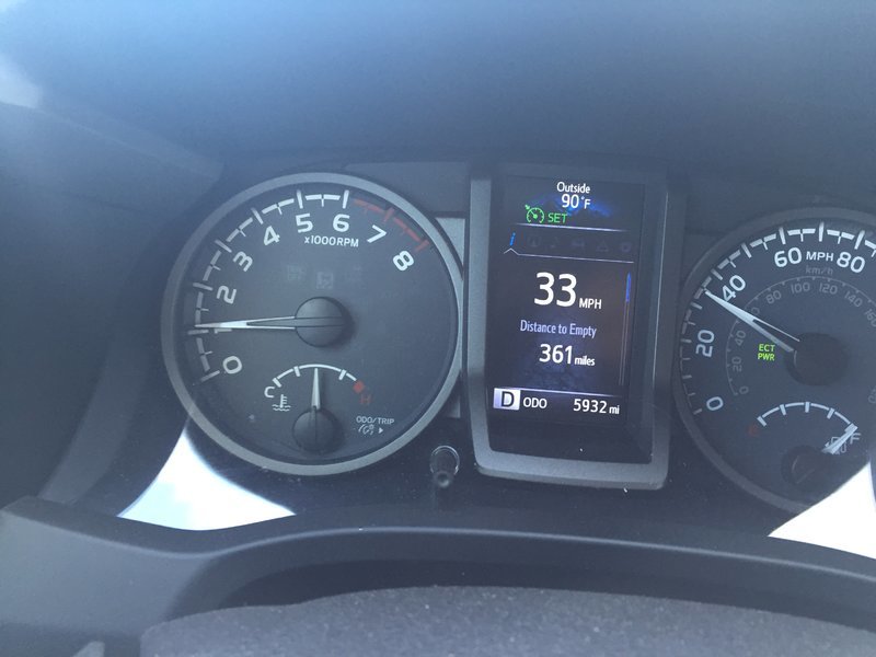

  16. Aug 12, 2016 at 4:13 PM
    #56
    Aussiek2000
    Aussiek2000 Well-Known Member
    Sep 5, 2015
    #163499
    5,652
    2016 Offroad AC
    Stupid thing running at 1000rom
  17. Aug 12, 2016 at 4:24 PM
    #57
    sethhawaii
    sethhawaii [OP] Well-Known Member
    Mar 21, 2016
    #181874
    296
    2016 TRD offroad 4x4
    looks like its at 1100 rpm.....lolz.... 100-200 more rpm would be be perfect rest . i wouldnt mind if it did go to 1k to save some gas once once its realized im just coasting here and there ....but seems for my trucks ultimate goal is stay at 1k and it wants to get back there as fast as it can. even if i just floored it and it downshifted 2 gears... let of the gas for a split second... intantly will upshift right back to 1k... so it creates a up shift down shift up shift downshifting if i need any responce
