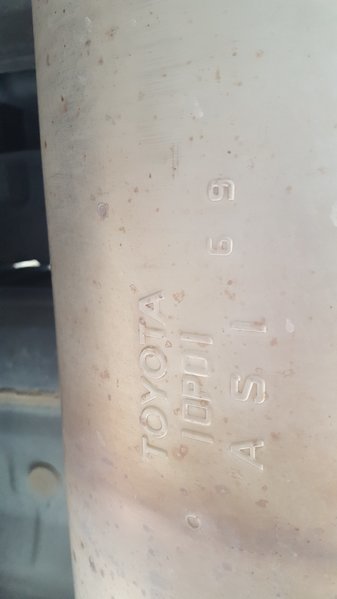

    While checking I grabbed the drive shaft from the passenger side and tried turning it and moving it and it feels solid. While down there I burned my arm on the muffler and got a nice tattoo
