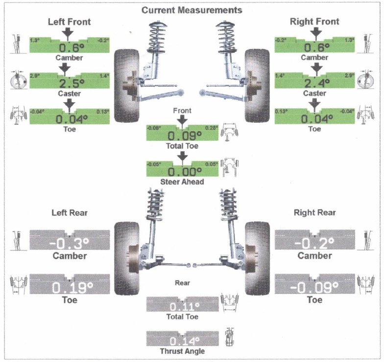

    Here's an alignment I had at a lifted truck center, best ride/alignment I ever got. I had 100% satisfaction, on surface streets and on highway, I normally run 70-72 mph on these 65-70mph highways. Truck tracked like nothing ever before. Take this to your alignment shop and ask why they can't hit these numbers.
    This was with the OME 2.5" lift front and back, medium springs, back in 2022. Nitto Grapplers, 265-70-17's.
    Get more caster, like @Vlady said.

    Get more caster

    You raised the center of gravity with lift and tires. Your tires have more sidewall. You removed the air dam, allowing more air under the truck. Why is it surprising that wind is affecting the handling more? You're not driving a Porsche, you're driving a billboard. If you're gonna play, you gotta pay...that payment is changes to handling. Learn how to drive your 'new' truck. And, as said, get more caster...caster is what helps the wheels self-center.

    Another one for caster..
    The alignment looks great, but I would kick the caster out a little more for better stability...
