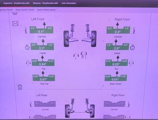

    Just got back from the tire shop. They checked the alignment and said it was fine. Dude drove my truck afterwards about 10 miles between 50 to 75 MPH and felt how it drove...I was with him.
    Is it just something I'm gonna have to get use to? Maybe I'm high thinking it would handle the same as it did stock?
