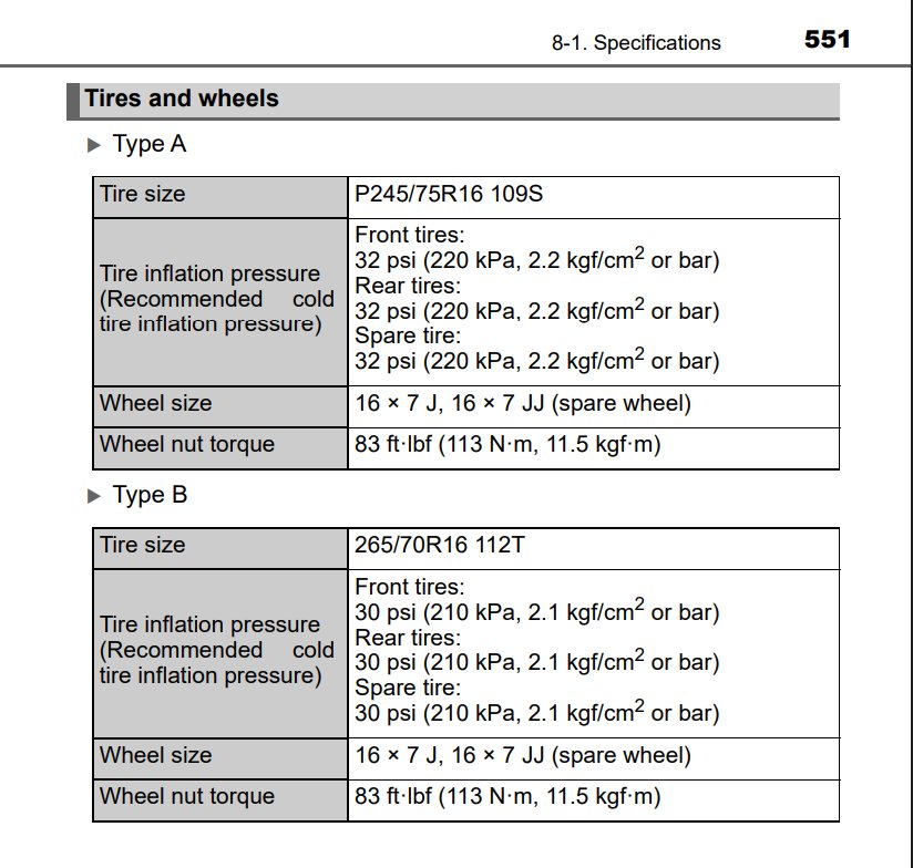

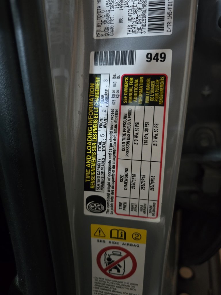

    SR5 sicker is for 245/75/16 tires.
    For 265-70-17' , OP needs to go 29 cold.
    OP issue is tires for given driving habits

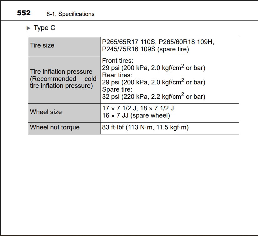

    My stock everything including 245/75R16 tires shows to run 32 psi, I have run from 30 up to 35 cold, I am running 35 cold now and it will jump up to 37-38 hot at speed and handles very well at high speeds...
