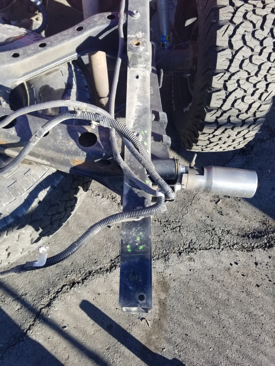

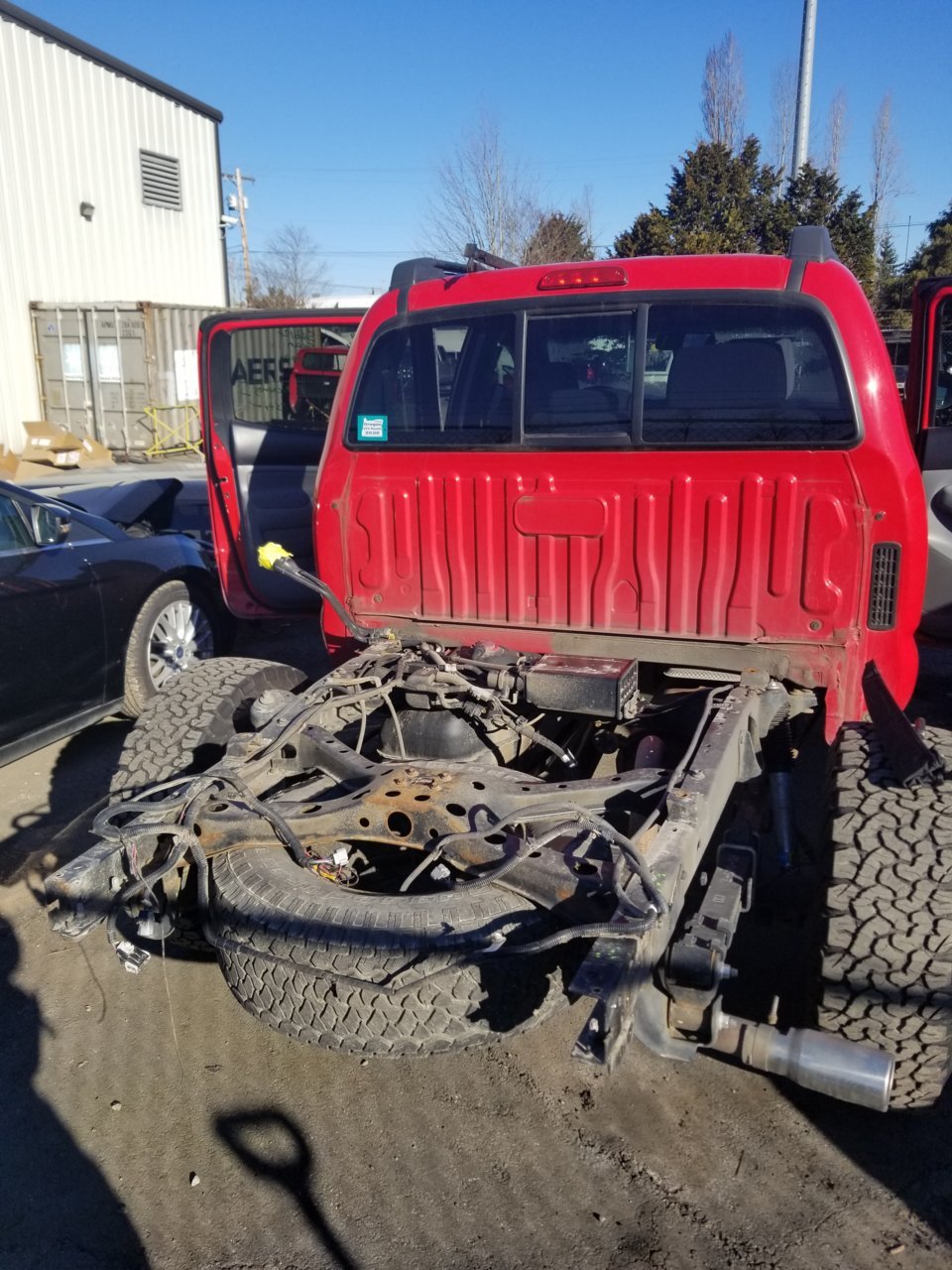

    Hey so here are some more pictures of the frame that I grabbed on Monday.
    20190304_092048.jpg 20190304_115058.jpg 20190304_092055.jpg 20190304_092048.jpg
    So I am debating on just buying it and keeping it until the wheels fall off then sell it or part it out. or both. Just to keep myself from having another car payment.

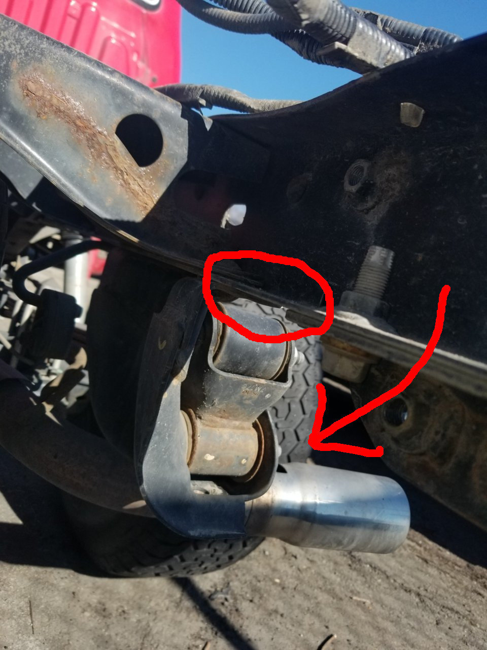

    I'm not seeing any bends in your frame at all from those pictures. Do you think you could be a bit more descriptive about what they're complaining about? I think they're definitely trying to pull a fast one, I have no doubt that that frame is fine and TOTALLY SAFE.
    When the frame on these trucks get bent from being rear ended, the damage is between the rear spring mount and the trailer hitch. That segment of the frame bends DOWN. In your pictures (in particular, the second picture), that segment of the frame is *perfectly straight*.
    EDIT: Here, I drew you a diagram describing how these trucks exhibit rear-end damage. Red circle is around the segment that crumples, and arrow shows where the end of the rails go.

    I dont see anything wrong with that frame,buy it back and fix it.

    That is what I am thinking, they never specified where the frame was bent. The only thing I could find and kind of expected was some sort of notation on the frame itself hence the green dots.. I was looking at the repair quote and found that they were basically going to replace a bunch of the bed and repaint a bunch of stuff. I will post the paper work here soon.

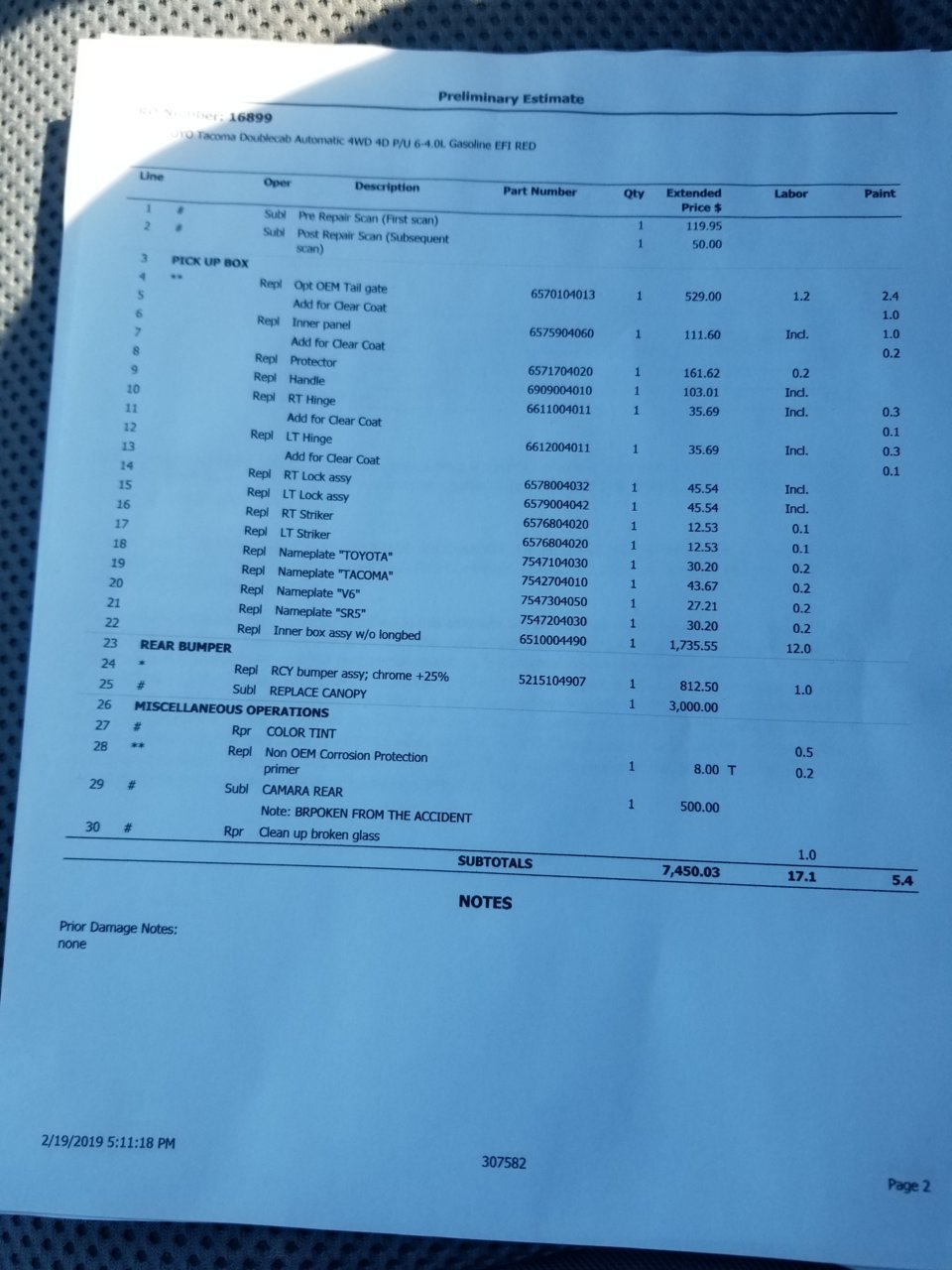

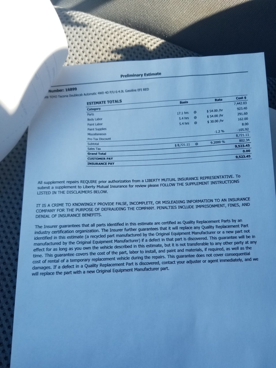

    Here is the quote, seems like so much more than I would have expected. And I don't think "fixing" the frame is on here. I guess I missed the part where they were going to completely replace my canopy.:facepalm:

    Yeah, doesn't look like frame damage. If the real cost is replacing the canopy, tailgate and the box itself, it's probably worth buying it back or keeping it and finding the parts yourself. If you're happy with the way the truck runs and drives, then I could see why you would want to keep it. Tailgates are on Craigslist and FB Marketplace all the time, the canopy you could take time looking for a good deal. The box might be the toughest part to deal with.

    Hey @YoungRed08 : No indication in this thread about the severity of damage to the bed, however, it is made of FIBERGLASS, which actually makes it pretty easy and inexpensive to repair.
    There's also a whole lot of miscellaneous bullshit in that quote. Lots of parts that are associated with the tailgate that you would get with a craigslist tailgate. You can use a $20 aftermarket camera instead of the $500 oem one (or leave it out altogether), and pick up a used back bumper from someone who bought an aftermarket bumper. Bet you can get the total repair price down to $1000 or less if you DIY. Well, minus the hat.
    And actually, the existing back bumper doesn't even look all that badly damaged. Nothing is visible from the picture, so you can probably just grab it and pull it back into shape.

    Yeah so as far as I could tell the only issue with the bed was where the hinge points were for the tailgate, other than that the side panels were fine as well as the fiberglass bed portion which didn't even scratch. As for the camera it was already a cheapo aftermarket one haha so I have idea why they would charge $500 for a $20 part other than to take the insurance to the cleaners. The bumper was also fine, not even a dent on it nor was the plastic on top of it damaged. The Lady that hit me was in a very lifted truck so she hit me square on the tailgate/canopy window. And that leads to the last thing is the canopy which isn't damaged in the slightest accept the window which just taking a shot in the dark but I would imagine a new window would only be a few hundred bucks. If I pick it up here soon I will try and get some more pics of the inside of the bed.

    He mentioned above that he inquired about buyback and they ballparked it at $5000. That, along with a settlement of $15,435.12 and repair estimate of $9523.45. That leaves a difference on the table of $911.55, which is too slim of a margin for them to take on the risk of the repair price going higher. Now *we* know that an honest repair of that damage will cost way less than the estimate, so OP can take the cash payout of $10,435.12, keep the truck, and everybody drives away happy.
