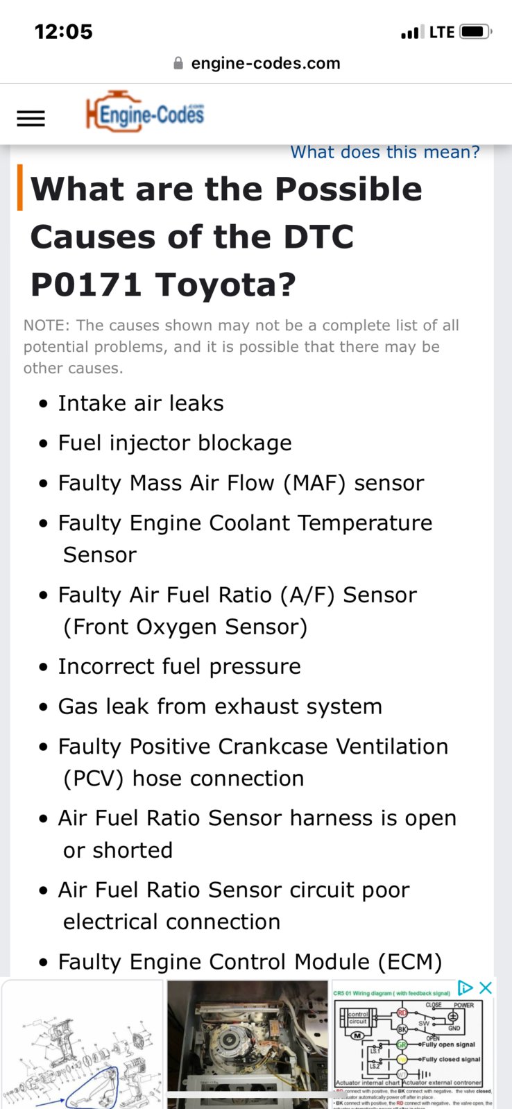

    Well after 30,000 miles from 192,000 to 222,000 I have always struggled to get the truck over 3000 RPM. I mean it runs fine it’s towed fine but you’ve got a shift at 3000 RPM. It being my second vehicle, I always just sort of live with it, but wondered. Anyway, I’m pressing it into more service. It’s only been getting 3500 miles a year probably gonna start putting more like seven or 8000 miles a year on it. It’s going in for new exhaust system as I’m getting the P0171 code and I know I’ve got exhaust leaks. Using the incardoc app recently led me to noticing wild fluctuations on the timing advance. Leading to an aha moment that I probably had a cam sensor or a crankshaft sensor problem, and that this may be the root of all the trouble with the rev limiter feeling. After a quick search of the Internet, it appears as if this is one of those sleeper problems, often not throwing any codes. Going to order a crankshaft sensor to have on hand when I pull the old one out. I’ve found some ohm readings to look for so hopefully it’s just gonna be obviously bad and I’ll throw the new one in. Really hoping that suddenly the truck will go to 5000 RPM! if anyone has experience with this feel free to chime in. I’ll post back here if the truck suddenly starts running like I’ve always thought it should. I’m gonna definitely feel like an idiot if this fixes the problem.

    P0171 is typically not associated with an exhaust leak. 171 is associated with an engine vacuum leak from the maf and after, vacuum lines

    P0171 also appears when fuel delivery is limited, there are no codes for fuel pump so if its running lean you need to investigate many things.
    Look at ST and LT Fuel trim, don't look at timing, its supposed to swing around rapidly. This is 100% not a crank sensor.
