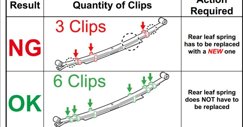

    Nah its OEM, or atleast homemade to mimic oem, part of a tsb where you get two new leaf packs. The 3 leafs were found to be weak, so they added another leaf and a few extra clips. If you take that 2008 to a dealer they will give you two brand new 4 leaf packs :) or should atleast....
