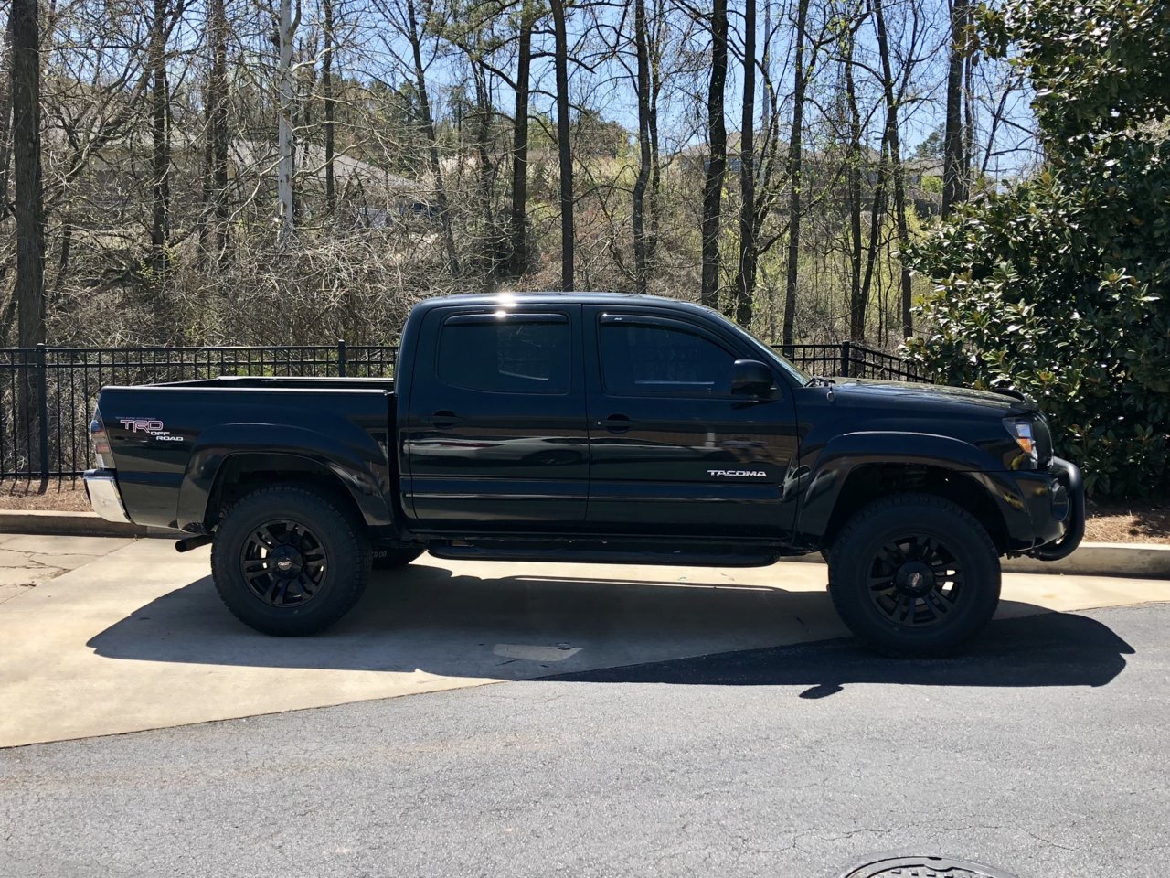

    What exactly is the “apex” of the fender flare? I plan on measuring tomorrow.

    Contemplating taking the step bars off...

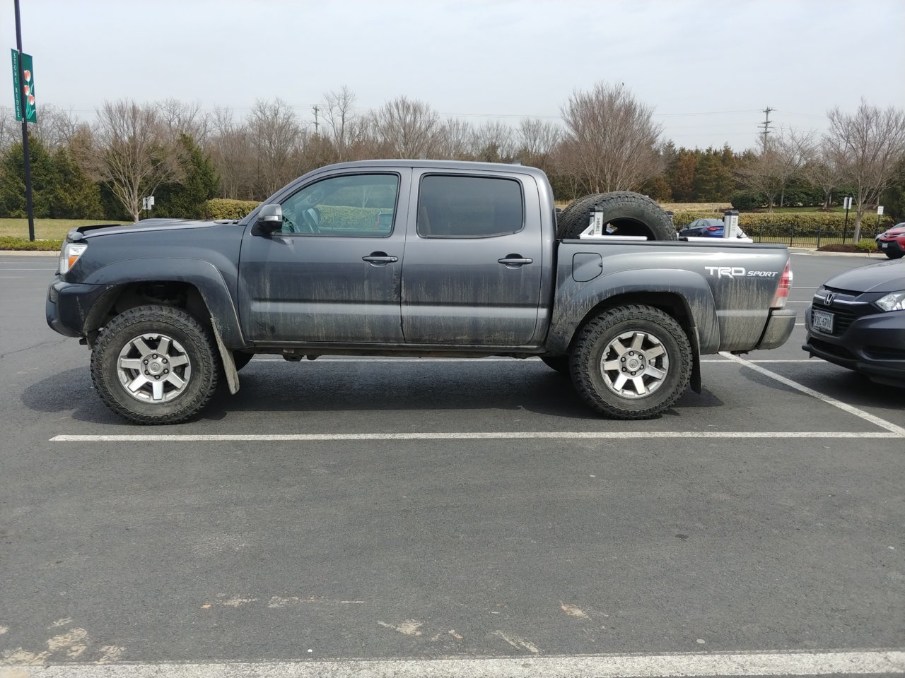

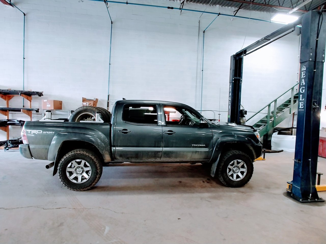

    Here are pics from my same install this week
    2nd
    255/80/17s installed0329181230.jpg
    3rd Deaver AAL put in that afternoon. Brought the rear back up 2" to give the slightest rake forward again0329181814.jpg

    Any issues with driveshaft vibrations?

    Brian
    Between North and South Virginia
    '15 DC MGM TRD Sport 4x4 6spd 4.0
    5100s, 885s, deaver AAL, Waiting impatiently to install Demello front bumper, Mobtown sliders & skids, and safari snorkel.
    None that ive noticed, ive been trying to trst out all scenarios, highway, rolling road, stop and go traffic, dirt road, 4x4, uphill, downhill, twisty road, with weight, w/o weight. No different then before lift.
    Maybe a little nicer on potholes due to new shocks.
    My post everything measurements to fender apex are DF- 39.5" PF- 40
    DR-40.25 PR- 40.5 with full tank of gas

    Honestly OP, if it's not exactly level, it's pretty darn close. Don't let perfection be the enemy of good enough!

    The very top center of the flare, the highest point. Should be directly over the wheel hub.
