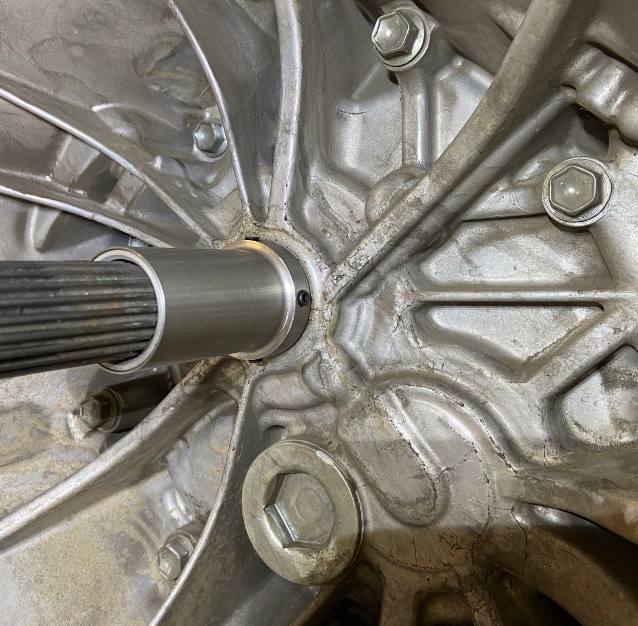

    A OEM clutch kit but get the URD clutch quill sleeve and do that while you're in there.

    Yup that's it and 100% just make sure you follow the instructions to the letter very carefully, hopefully yours isn't as scarred as mine was. Though mine was pretty bad it isn't the worst one I've seen on here by half; the real bad ones ultimately snap off and because of how that quill is cast into the transmission end plate in order to remove that plate you have to completely tear down the transmission and basically you'll end up getting a new transmission if you don't.

    I also have that urd sleeve and after 20k miles I am experiencing the squeak at the throwout bearing still. I am pretty hard on the clutch though.

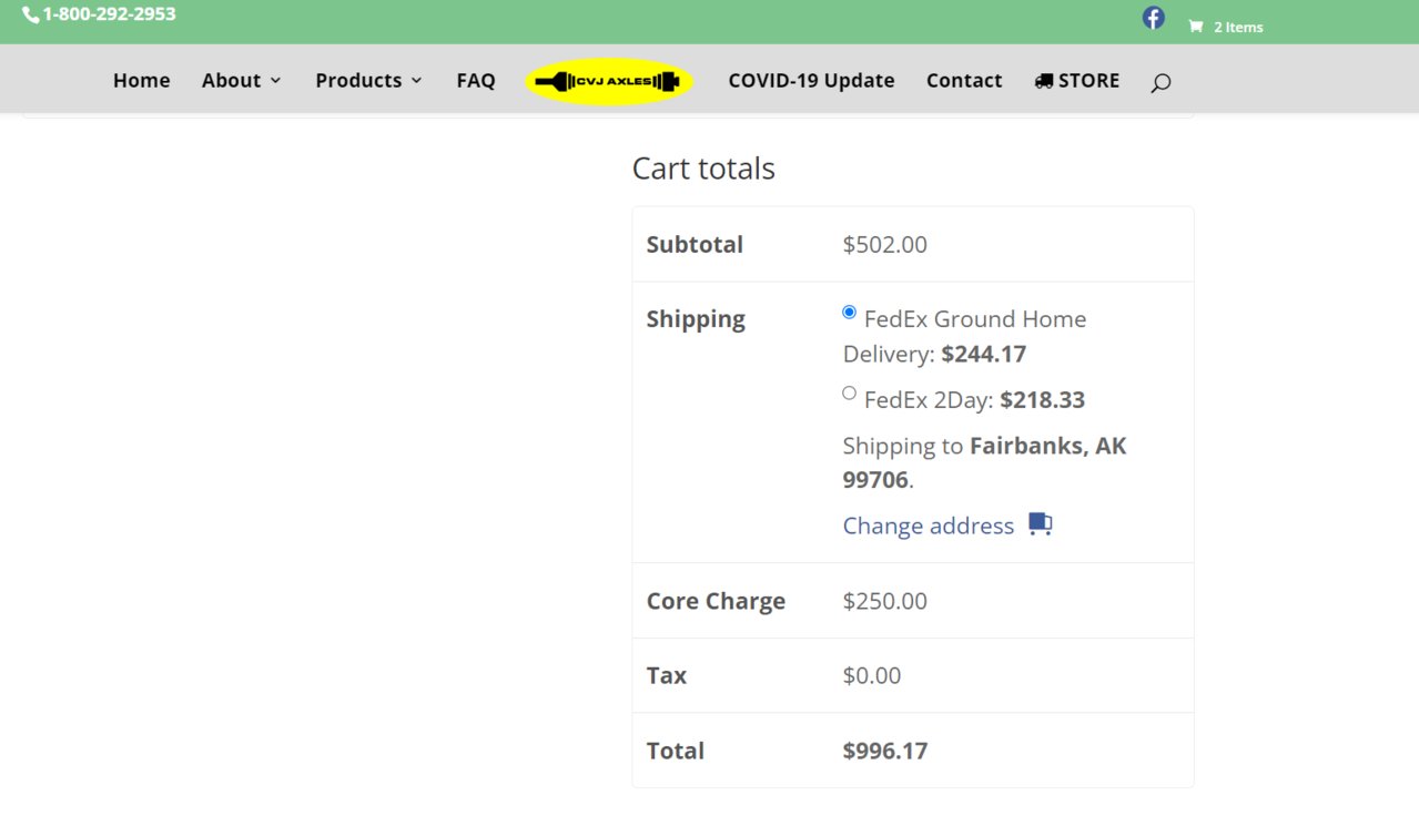

    How did you feel about the install on that sleeve? I might buy your kit and flywheel. I wonder how much the shipping will be up here though. Sometimes its fine and sometimes the shipping will be 200or even 300 with the post office. I try to milk Amazon and free shipping as much as I can. One company just tried to charge me 120 buck to ship the shocks.

    another vote for the URD sleeve TOB. I installed one on an FJ (same transmission) and it's a decent bandaid for the wear on the stock snout.

    You have to buy URDs bearing. it's a modified stock bearing.
    Once you see how badly scored your stock snout is it will make sense.
    Worst case you remove the sleeve and re-install a stock bearing. It is mildly glued in, but some heat should allow easy removal.

    Sorry man, I already found a free shipping place. Shipping it freight would take some two weeks, and anything faster blows the deal. Its just how it is here. I gotta milk these commercial high volume shipping accounts. Its just how it is. Good luck with your sale though. Sometimes retailers cancel my orders because they don't want to deal with Alaska shipping. If that happens I'll buy yours. I will know when the tracking info hits and let you know.
