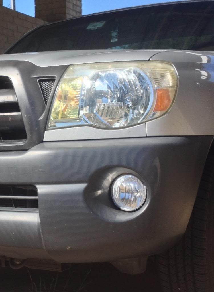

    I tried attaching a polishing piece to the end of a drill and liberally applying water to try and clear them, with the results that you see in the picture.
    The grille is sun-faded and discolored underneath the plasti-dip; I think I am going to buy a brand new SSM/chrome and Satoshi it eventually. I would re-derp it right now, but I don't think the parking enforcement on campus would be to pleased about that.
    Here's a bit better look at the bumper...it looks like waves. Only visible in direct sunlight.

    Looks like at least the part of the light that you need cleaned up okay. Living where you are the sun is more intense and for more of the year than myself here in New England. It could be that inside has faded, in which case you'll need to open them up and that's a pain. Might be better to buy a good aftermarket set, not the Flea-Bay crapola. The name brand escapes me but I've heard of one that's pretty good and reasonably priced here.
    Chrome might be your better long term bet on the grille. I'm a firm believer that short of a full bra (which I'm not a fan of, for the record) you'll eventually run into that.
    The bumper..not sure, but try one of the plastic cleaning products. Wipe-New might help, I've heard mixed reviews but it's only 20 bucks or so..worth a roll of the dice if it works.

    For your headlights wet sand them down with 1000 sand paper evenly until they are dull then clean well with water and wet sand with 1500 clean off and use a good polish. I like mothers scratch and polish wax
    For any of your black trim you can use all the crap they sell but will only last for a bit or you can use a heat gun. If you want to know how to do it with heat just message me ill explain

    For your headlights you need to sand them to get rid of that yellowing. Just polishing never works for me. I usually just take 3000 girt sandpaper and wet sand it down quite a bit and then shine it up with some cut polish.
    I think the heat gun is probably the best way to restore the plastic. I'm not sure how the plastic will react to being heated up a bunch of times though,
