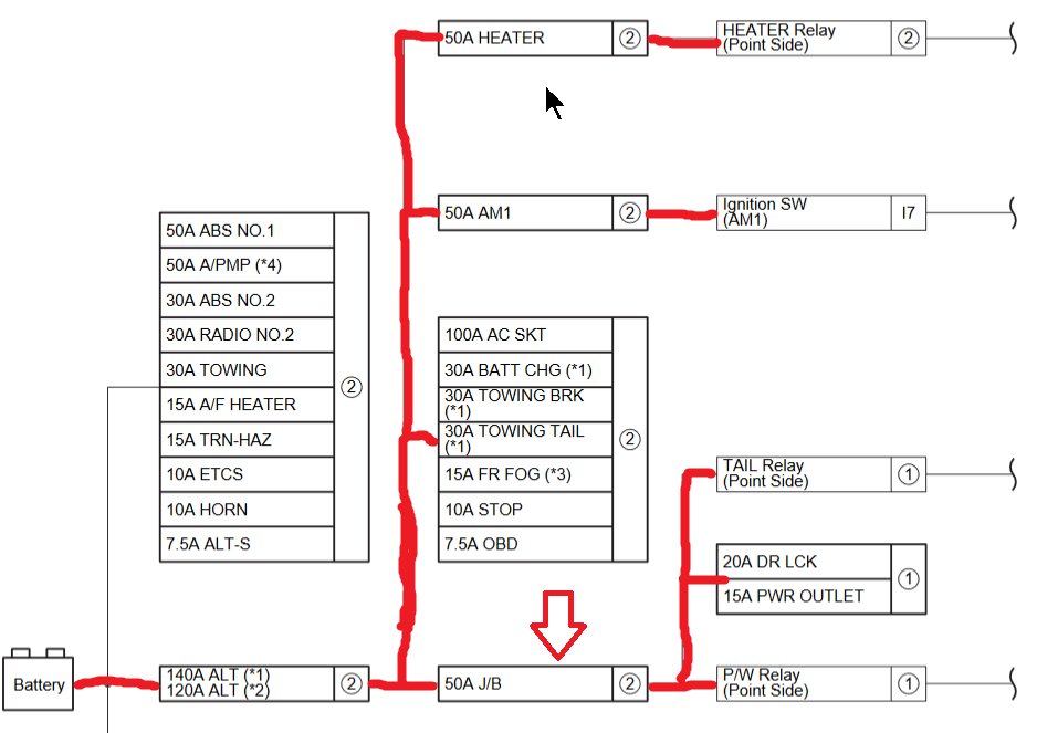

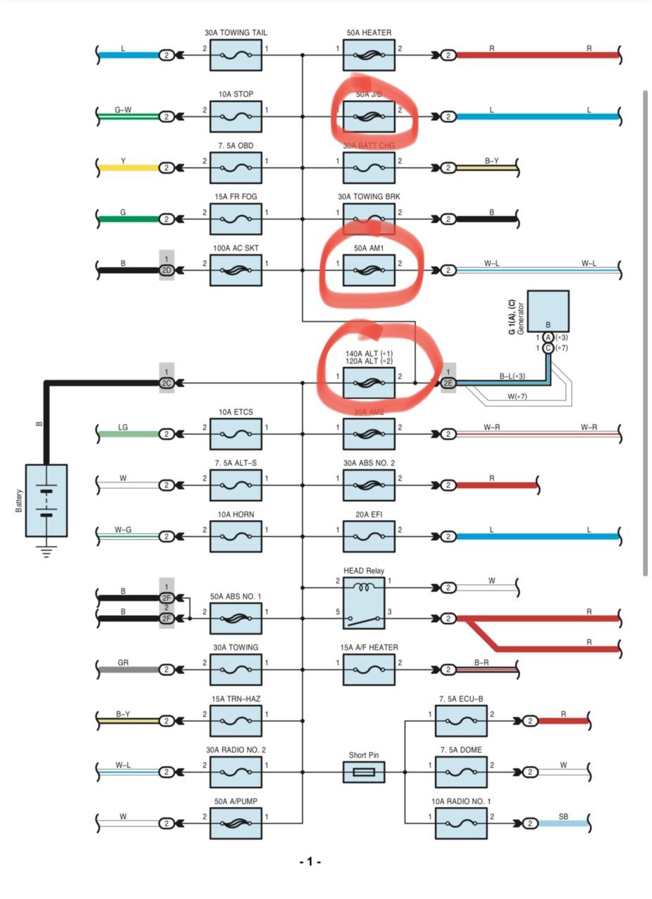

    I’m going to guess the 140 amp alternator fuse is blown. It unbolts from the bottom of the fuse box. The 50A J/B goes to power windows and the 50A AM1 is used for staring circuit. Unlikely both of those are blown individually.

    If the heater, Stop Lights, Fog Lights etc aren't working also then it is probably the Alt Fuse 140 or 160 Amps. If it is just the Power Windows and Locks Power outlets and Tails it is more likely the 50 amp JB fuse.

    well it was alternator fuse.
