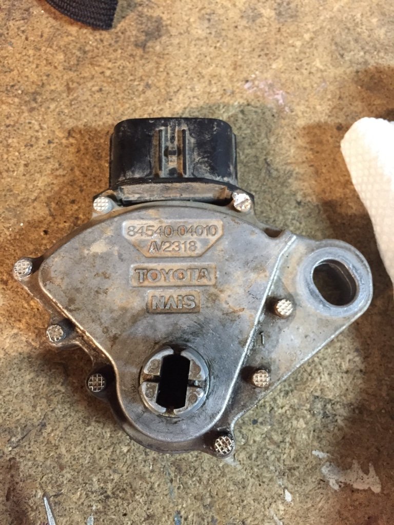

    So I pulled this of the trans last night, I believe it's the park revers neutral switch, I was going to open it and clean it, but it's sealed. I tried to clean it as good as I could, but nothing changed, the truck is still blowing the ign 1 fuse when I put it in reverse. Running out of ideas here...

    no the switch im thinking of is in the center console, that controls the reverse lights as far as i know.

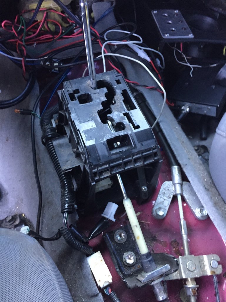

    I took apart the center console too, but it got to a point where I couldn't take apart the shifter box anymore, at least I think. I will try again this evening. I need to find a picture so I know what I am looking for haha

    trace the wires that connect to the shifter in the center console thats where you are going to likely find the issue. Its going to be a multi point position switch of sorts and likely the contacts are corroded or something. Also did you check out the junction point by the driver side kick panel that i posted a couple posts back in reference to that tsb?

    Any idea how to get this thing open?

    Update:
    After not being able to break it down, I cleaned what I could and checked all connections. Didn't really do anything different, but for about 24 hours, everything was working. Then it popped again when I was putting it in reverse later, after not having issues.
    I was able to get the shifter open, and broke it all down, I cleaned everything with no issues later, but it still wasn't working.
    This is where I sit now, I'm not sure what caused it to work, but it did for a little bit, not I cannot figure it out again. Really running on empty here, not sure what is going on with it at all.
