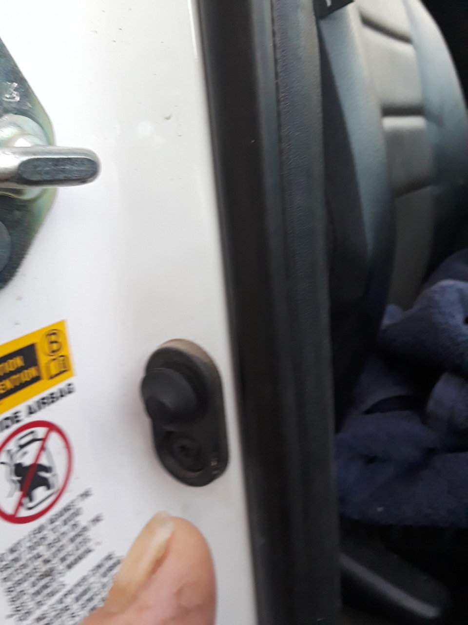

    What part of the door is supposed to register that its open? And where is it to check?
    tcjacado[QUOTED] likes this.
  5. Dec 1, 2018 at 4:07 PM
    tcjacado
    tcjacado Well-Known Member
    Aug 29, 2016
    #195947
    41,570
    It is in the door jam covered by a little rubber boot. You cant miss it.

    Yup, you'll know you have the right piece when the lights go out when pressed in.

    Hang on I will get you a pic of loaction

    This is my passenger side but same location in all 4 doors.

    OK. That's called the pin.
    If it's bad how do I know? Lights go off but come back on 20 minutes later when no one has touched the doors.

    Looks picture perfect.

    I would just pull the negative on the battery until you can get it resolved.
    Edit... most likely the plunger is bad on it and will need replaced.
