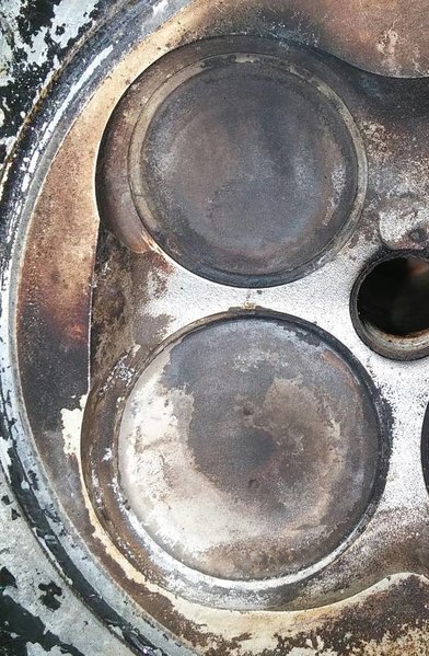

    I have a 2000 sr5 v6, did everything plug wires, coils, injectors ( reinstall the original injectors after I found out the new ones were leaking). decided to buy a leak down test kit and found out I had a leak in the exhaust. took passenger head off and found out that I had a hairline crack in cylinder 2. looks pretty darn good for 220k miles minus the crack.
