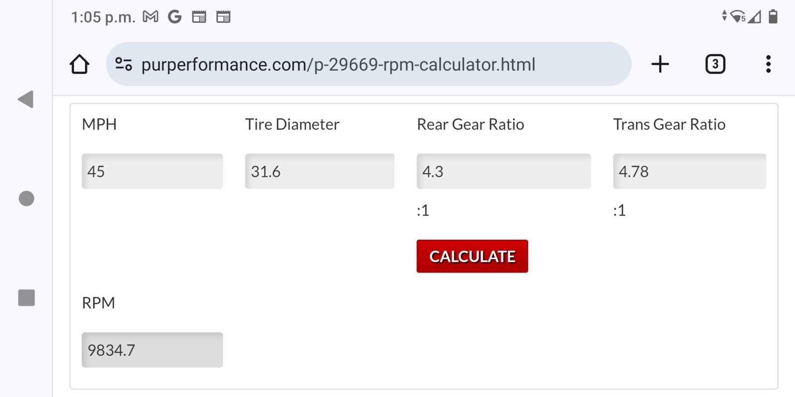

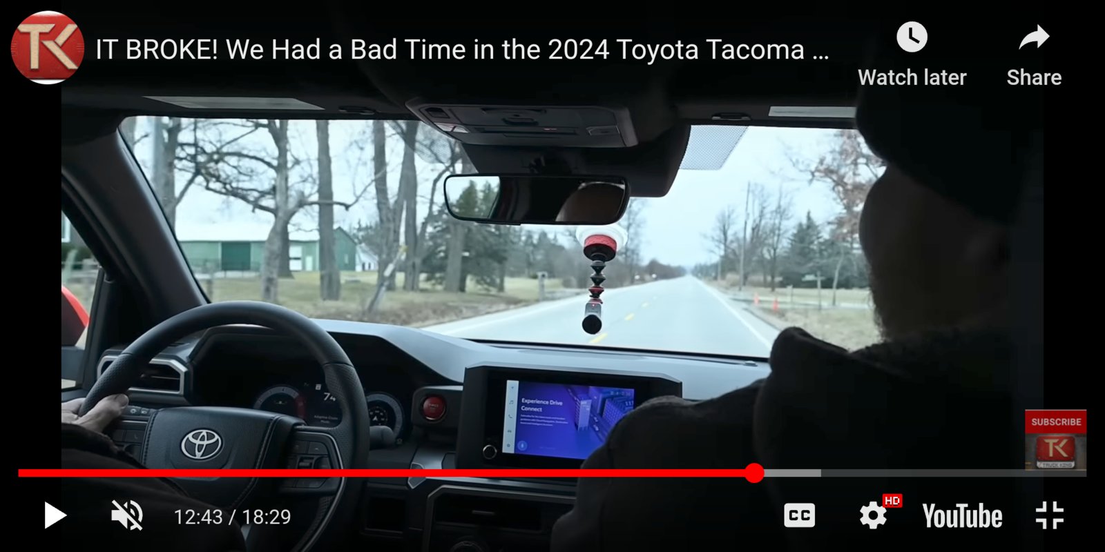

    I was bored, so I did a little investigating with the evidence/facts available.
    Screenshot shows 74 km/hr, and this is after Dad ground it (probably fell a bit while he was dicking around).
    Here's what the 1st gear synchro was trying to do (Toyota's theory):
    Almost 10k rpm. Oh yeah, clutch should have totally stood up to that :rofl:
