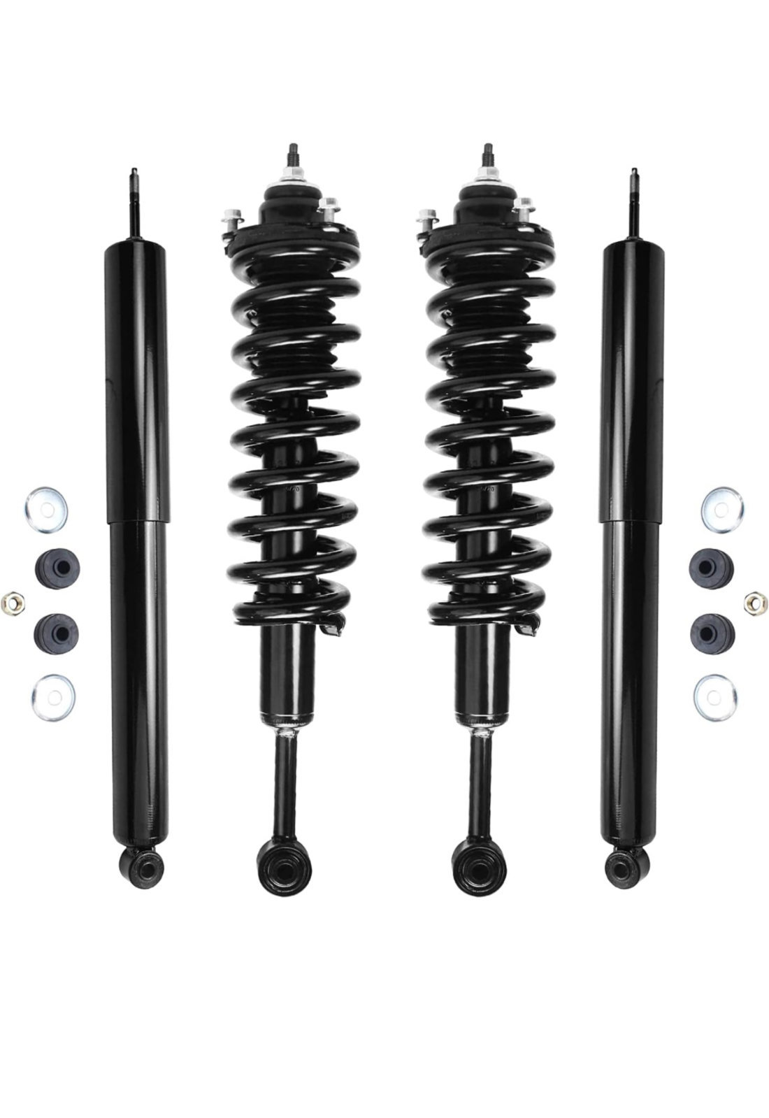

    I know I appreciate it I can just get front and back for $175upload_2023-12-2_14-35-37.jpg

    Do what works for you.

    If you aren't trying to lift the truck or increase off-road handling performance, just replace the OEM / Toyota front coilovers with replacements from a 2nd gen Taco with less than 30K on it, maybe at a junk yard, or better yet someone's take-offs when they upgraded their truck to FOX/King etc. aftermarket suspension.
    Don't go with no-name generic replacements, you'll have to replace the replacements a lot sooner.
    Seems likely you might also need new UCAs, new bushings for everything too.

    After watching a bunch of videos on replacing Tacoma struts I went with Monroe it seemed to be what everyone was using and I’m going to do the work myself work is slow right now so I’m just trying to do things as they come at me is there something I should definitely do next I don’t want to have strut go bad faster bc I didn’t replace X sorry I don’t know much about vehicles trying to learn and I really like my Tacoma and want to keep it going the best I can
