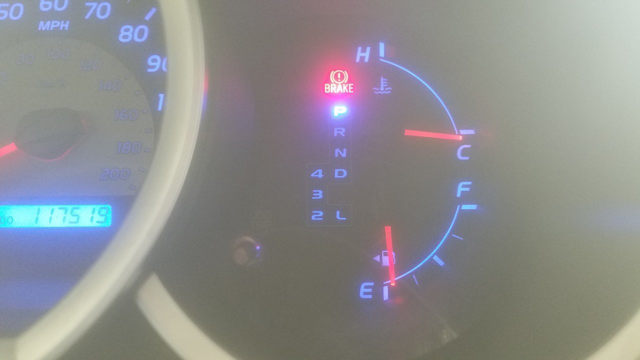

    Headed to work this morning when all of a sudden, engine stalls out on me. Pulled over and realized i was out of gas. The problem was, my fuel guage indicated I still had gas left.
    When i left my house my Ultra Guage alarm went off saying 20 miles till empty. I looked at my trucks cluster fuel guage and it showed me 1/16 tank above E remaining. Low fuel light was not on yet. I figured i got gas at some point and forgot to update my ultra guage which would explain why it was telling me I was out of gas. Well... apparently my Ultra Guage was right becuse i made it almost exactly 20 miles when it stalled.
    Added roughly 2 gallons from a gas can and headed home. The needle did not change from its 1/16th position.
    I went to the gas station right now and filled up. I added 21.26 gallons just now which is more then the tank supposedly holds lol. Meanwhile, I still showed 1/16 remaining when i began fueling up and no gas light. After fill up, my needle went all the way back up above the full line like it should. For now ill track mileage, fill up more often, and use my UG for gas level, but any ideas what could cause the needle to not go less then 1/16th?
    Its not stuck because when i shut the engine off the needle drops down below E as it should. It has full range of motion from below E to above F. I feel like its a sensor issue but have no idea how this truck gets its fuel level data. Any insight on things to check?
    Here is a pic just moments before putting over 21 gallons in the tank:
    All other guages work fine. No CEL (and yes it works). No other known issues. 2009 DCSB 4.0 Prerunner. 117520 miles. All maintenance up to date.
    TIA

    The sensor in the tank is nothing more than a variable resistor with an arm and a float. It may just have gotten stuck.

    Weird. My gas light comes on at roughly the same position. If I fill up as soon as the light comes on, the truck usually takes 17 gallons to fill back up.
    Maybe the float sticks? Or is going bad and there is a dead spot in it where the resistance doesnt read correct?

    Similar to like the float usedin a toilet tank? I'll know after this tank if it was just a fluke or if the problem is consistant
    Yeah my light usually comes on there as well and thats when i fill up which is also 17-18 gallons. Just this time it decided to not turn on.
    So if this resistor if bad, does anyone know if it requires dropping the tank to replace?

    Nope definitely not. I think has it dropped just a hair more it would have turned on. But for some reason it thinks i have more gas then i do. Im guessing this float thing was stuck or more likely the resistor or sensor is going back. Trying to find part numbers and diagrams now

    Same thing happened in my 2010 last year. Stalled out while I was driving on the highway, but the gauge still showed about an 1/8 of a tank, maybe sightly less. Ended up having it towed to the dealership because I thought something was wrong. Turned out I had run out of gas, but the gauge made me think I still had a little left. The dealership replaced a "fuel level sensor" which may be the resistor you guys are talking about. I also ordered an aftermarket fuel pump and had it installed later by a mechanic from an offroad club that gave me a good deal.
    Turns out when it was at the dealership they discovered I had a timing cover leak, so they replaced a bunch of seals and gaskets under warranty, so it didn't turn out that bad.
    But having had the same issue, it's probably your fuel level sensor (float?) that is giving false readings.
    So either A.) fill up early and often, and it will *Probably* be ok, you'll just have a false reading when it's low. Or B.) replace the fuel sensor and if you chronically run the fuel to E like me, you might consider replacing the fuel pump. Something I read about the pump being cooled by the fuel, no fuel = no cooling.

    Seriously either the float is sticking or maybe sign of fuel pump going south. When I had a Silverado :anonymous: my fuel gauge started acting funny right before the pump went out. They are both in the tank. good luck.

    Guages haven't been removed since 2009 when i did the led swap, so the alignment is surely fine. @Jerez is clear on this one lol

    Can you put a pic of the whole gauge cluster?

    Ill try to remember tomorrow. My camera on my phone is cracked so my pictures come put really hazy and cloudy right now. Ill have a new phone Thursday but just advanced warning the picture will kinda suck

    This apparently is what i will have to do going forward haha.
