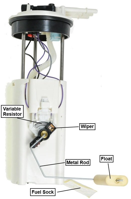

    The gauge is just an estimate ballpark of what is in the tank.
    OP if you decide to go in and check the float; it is easier to remove the bed from the truck than it is to drop the tank.

    I’ve had my float gauge or whatever it’s called get stuck once. Filled my tank up from roughly 1/2 and got back in the truck and it still read at 1/2, then I drove around for a few miles and I guess that freed up the gauge and it rose back up to F. Hasn’t done it again since.

    I’ve seen 5 other trucks run out of fuel at the same mark. I’m willing to say that it was the fuel leveler (float gauge) inside the tank that got stuck

    I realize that it's apples and oranges, but C5 corvettes have pretty sensitive fuel floats, apparently, and running a can of Techron fuel system additive was was always a quick fix when it happened on mine. It's probably not a bad idea to run a can and give it a shot; it can't hurt and will only cost you a couple of bucks.

    Not sure about gauge cluster mods and the potential inaccuracy or damage to the gauges from removing and installing needles
    But it is rare for the float to stick. Usually there is a problem with the variable resistor and wiper getting corroded and then sending out the wrong reading.
