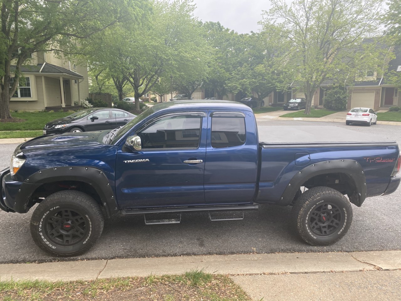

    I have the icon rxt leaf packs set at option 3. I think my best choice will be 887 right?

    yeah as long as you dont plan on adding a bumper/winch/armor upfront.

    Nice! I’m thinking 275s or 285 on the rim 17 I have and gonna sell those tires. They barely have 2k miles in them but they look weird with the lift the truck is running on mine

    Well installed the 887 in today with 5100 at 0. Looks good I’d say getting it re-aligned currently
