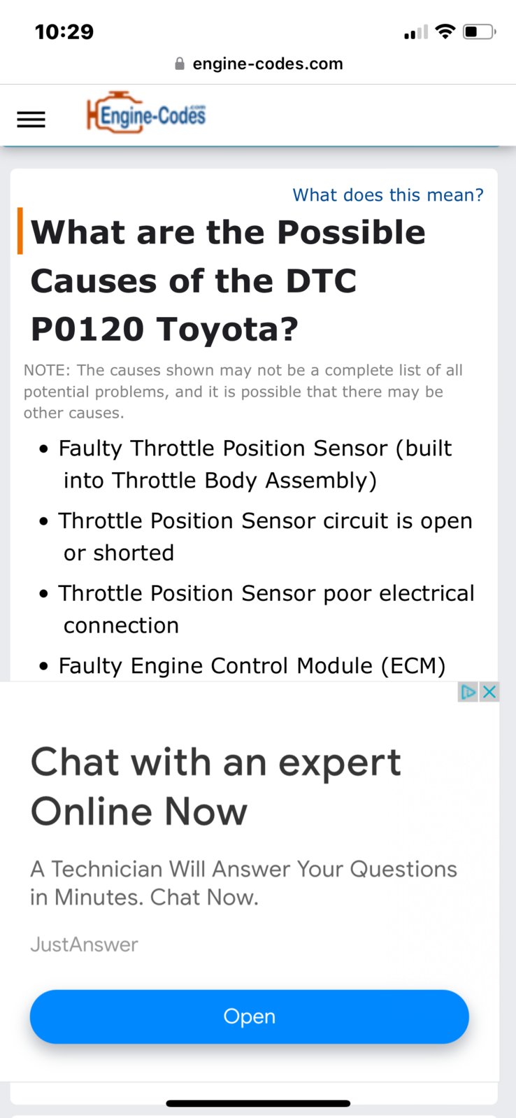

    I got a PO120 this morning right a start up but it has never thrown a code while driving and then acting up.

    thats what i have thought. I hate throwing parts at it because the ones i have thrown hadn’t been the problem. I’m a little out of my leage on this. There is a shop about 30 minutes from me that works on Toyota’s. I have thought about taking it in and seeing what they can come up with.
