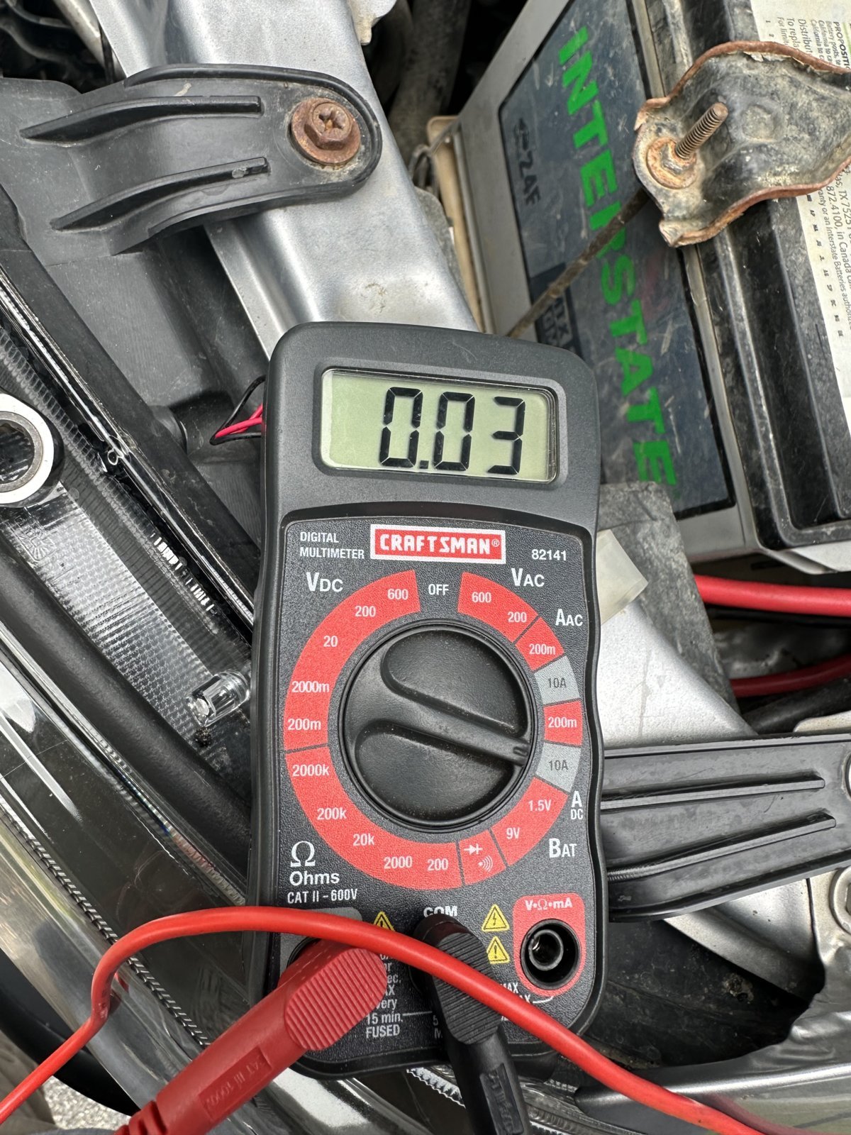

    Stumped on this one. This is acceptable for these trucks in assuming? Battery was 12.6v when I took the cable off to test. Going to leave the meter on for a little bit and see if something changes. IMG_2762.jpg

    That's 30mA, generally anything under 50mA is considered ok.
    Seems a bit high for a truck with so little electronics but I've never checked mine so I couldn't tell you what the norm is, each vehicle is different though.
    30mA isn't gona kill your battery overnight though, it would take a couple weeks or more at that rate.

    If you reconfigure your meter to the 200m setting you’ll get a better measurement. That’s really too little for the 10A setting.

    After almost 12 hours it struggles to start unfortunately.
    Are you saying to turn the dial up to the 200m setting above it? I’m not the best at using a multimeter I’ll be honest lol

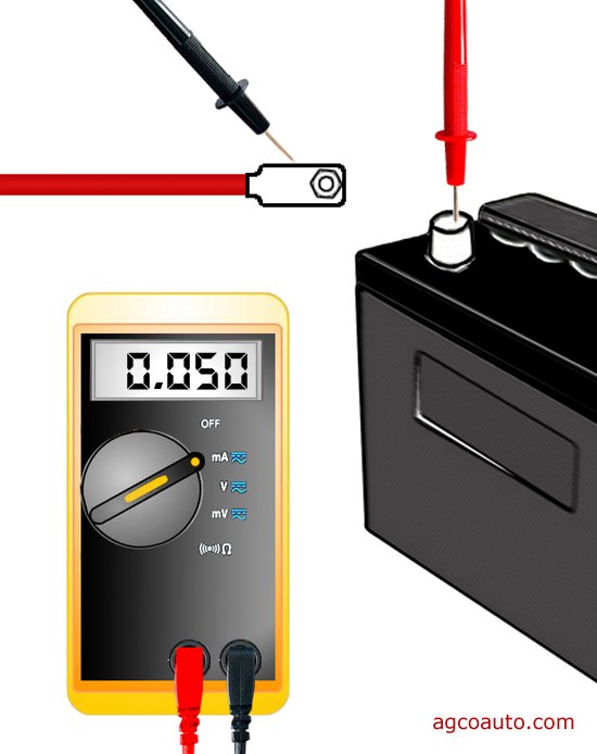

    To change the multi meter move the dial to the 200ma dc setting above the 10a like you said but you need to swap the red lead to the right hole and leave the black on com. I also assume you disconnected one of the leads of the battery and have the meter in series between the battery post and leads like below. It doesn't matter if you disconnected the positive or negative but I would do the negative for safety so you don't short out your battery by accident.

    I don't think you will be able to use the 200mA setting because most vehicles take much more than 200mA when they first power up so it would likely blow you meter fuse.
    10A scale should be sufficient as you can measure down to 10mA.

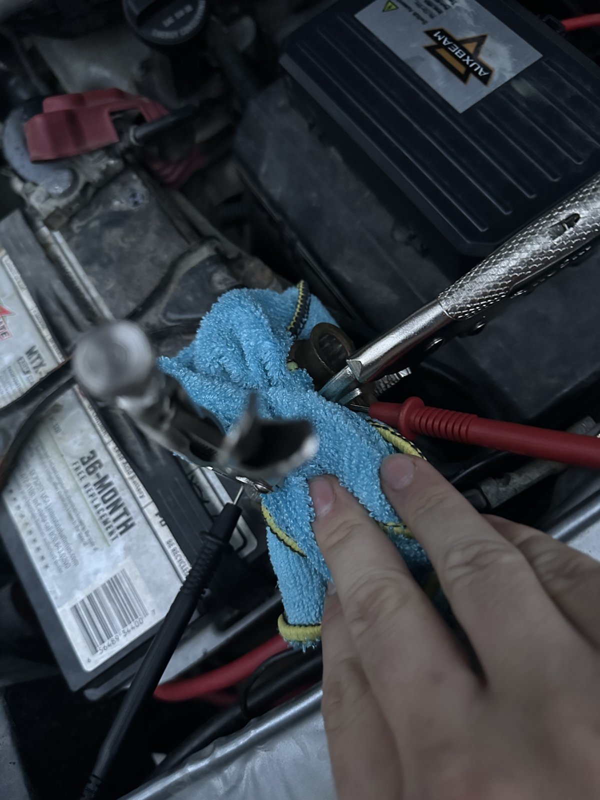

    yes I have it connected to the neg cable (excuse my horrible picture but just wanted to show I’m not doing it wrong lol) IMG_2765.jpg
    I have it like this right now just to make sure the truck doesn’t have something turn on after a few hours and stay on. I know these trucks run some kind of random diagnostic every time you turn off the ignition so I want to make sure that isn’t the culprit. So far so good.
    I know after 5 hours or so the fuel pump comes on aswell with that diag so I’m waiting to make sure that one isn’t keeping something on before I look at the battery. (Hopefully this made sense to those who know what I’m talking about)

    That is a good point I forgot to mention to not turn on the key or anything else. I was more wanting to make sure the budget meter was somewhat accurate at low draw on the 10a setting. Both of my meters are auto ranging and I have not used a cheaper one before.
