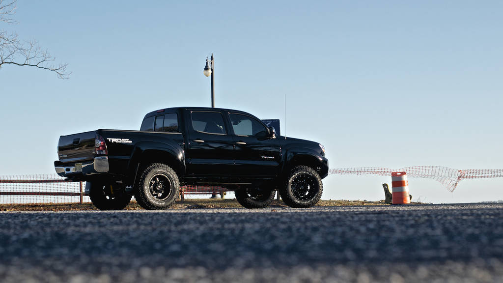

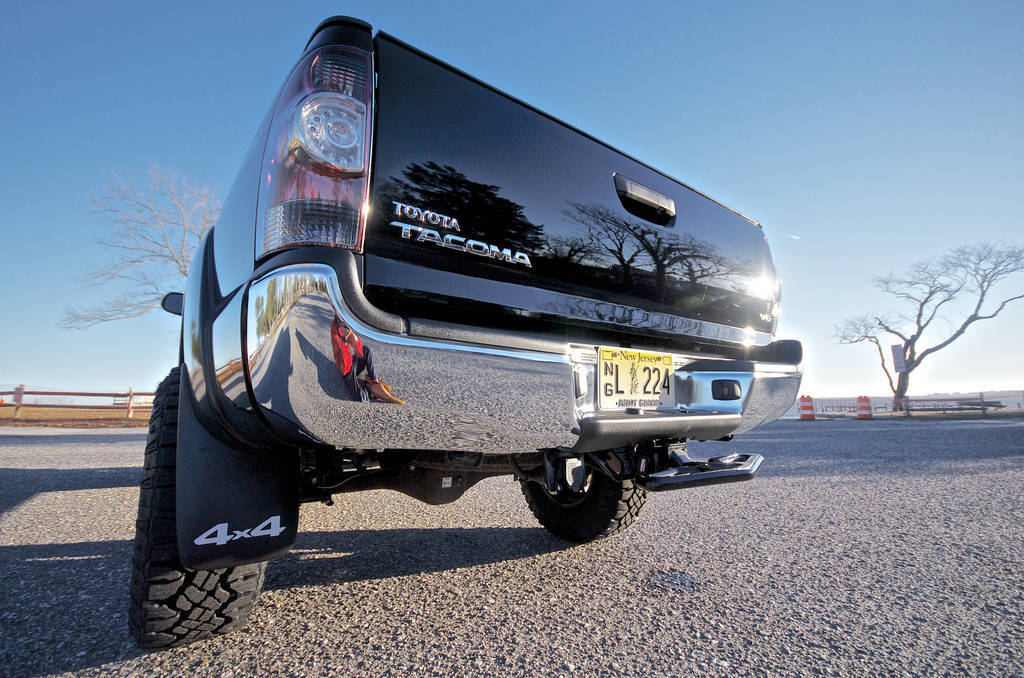

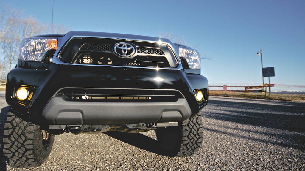

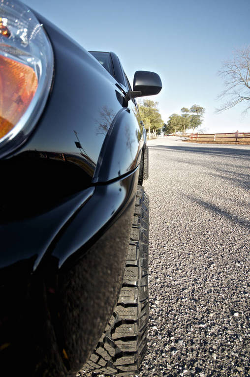

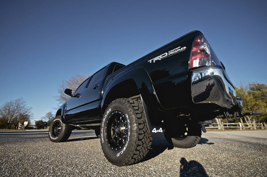

    Looks good, I think. I can't really tell what the stance actually looks like because of the distortion from the pictures and the angles you used...

    sorry i used a really wide angle lens to take the close up shots
    the tires stick out about 1.5 inches from the fenders minimal rubbing only in reverse or if i fly up my driveway too fast. haven't trimmed yet

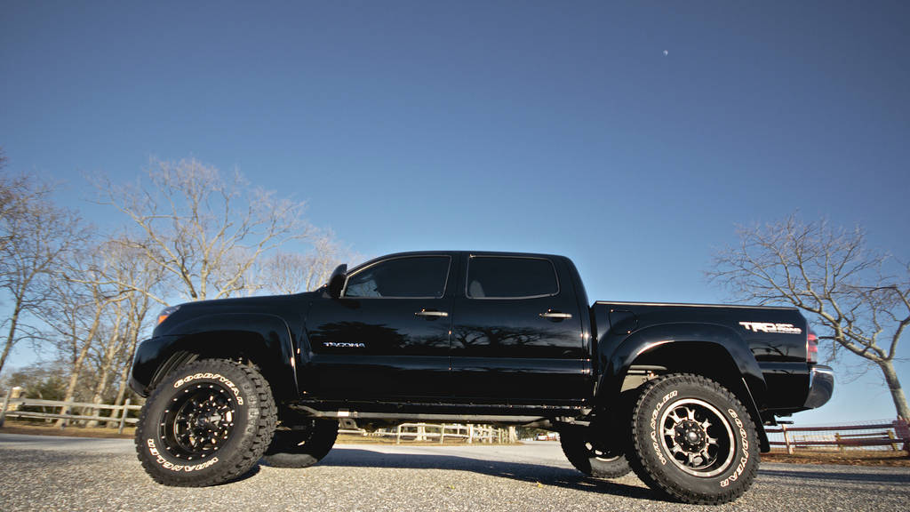

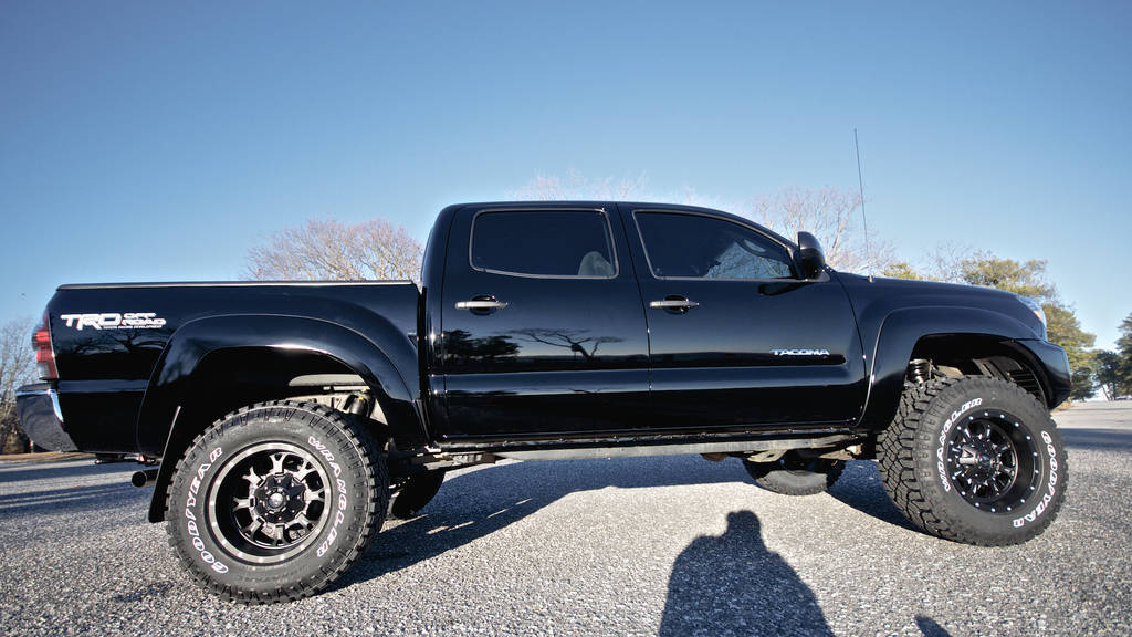

    Looks great! Chrome gets no love around here, but I really like it with your BSP paint! What size tires, what type of lift, and did you have to do any tricks (spacers or inner fender cutting) to get the tires to fit? Also, are those wheels from the T|X Pro?

    Shoes:
    17x9 rims, 4.5 back space, -12mm offset, Goodyear Duratracs in 285-70-17
    no wheel spacers
    Trimming: (havent cut yet, but it rubs on the fender near the cab mount in reverse, only rubs passenger side cab mount in reverse also. when go up my driveway too fast it rubs these areas as well) my caster is at 1.4 will get it aligned again next week and tell the tech to put caster at 2.8++ that should alleviate some rubbing issues. letting it rub for now so i know where it needs to be trimmed, then will trim if needed after my 2nd alignment
    Suspension:
    Old Man Emu 885 with top plate spacers for full 3" lift and driver side trim packer with OME 9000 shocks front and rear
    Dakar Rear Leaf packs part number# CS047R with no add a leaf
    Total Chaos Upper Control Arms
    Removed front sway bar

    i did the lift myself, yes sir, its pretty straight forward if you have any mechanical ability or worked on cars before. i didnt have any issues except when installing the rear leaf packs, a helping hand would have been nice as they are not extremely heavy (they're still pretty heavy) but trying to hold them up for a few minutes and trying to align the holes to put the bolts in.. it gets pretty fing heavy. it would behoove you to take some advil before and after the install. i have 2.5 degree axle shims with slight vibration from 7-10mph (i had this when it was stock though so i duno) and above 60+mph i get some vibes, i probably should have gotten the 3.0 degree, im gonna do the center bearing drop in the near future to see if that helps first before i go tearing down the rear again
    i had the front shocks and coils pre assembled when i ordered them, so it was a direct swap with the stock. very simple, best 100 dollars extra ive ever spent.
    i removed the front sway bar because it was hitting, or really close the lower spring perch mount of the new OME set up. i rarely take the the truck over 60+mph, i have a car and motorcycle for that, and i wanted more articulation/stability while off road
