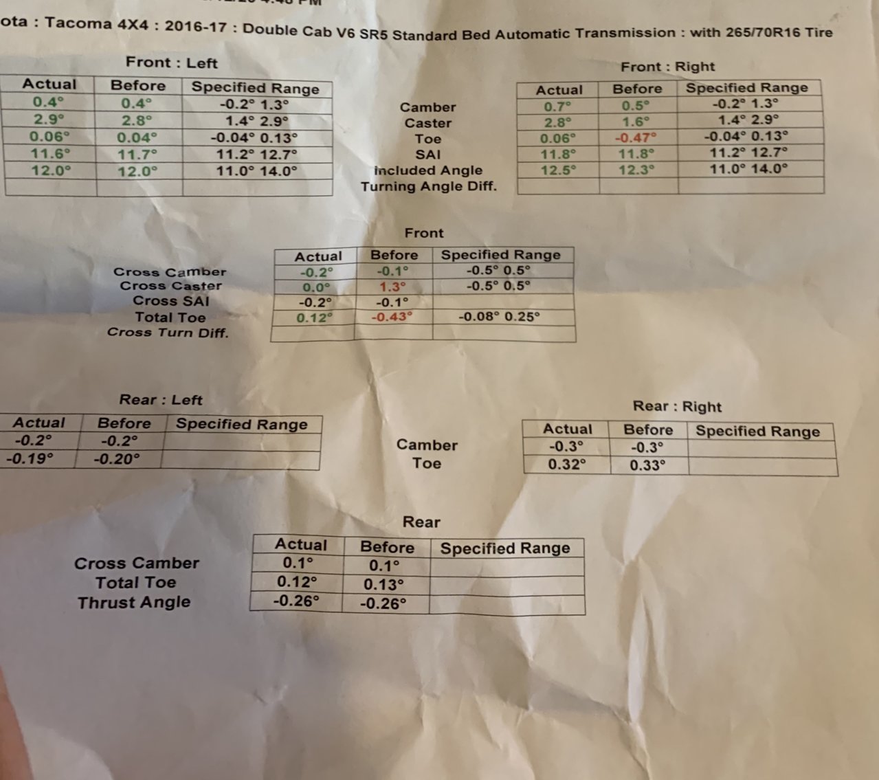

    Hey All,
    I recently got an alignment after I went to 33s with new wheels. My truck has been pulling to the left. In order to drive straight I need to hold my steering wheel to the right. I hope nothing is bent below. My stock skid is on its last leg, aftermarket one is in the mail.
    can anyone recognize anything weird with my alignment ? I am going in again next week for the shop to check it out again.

    I don't think your steering wheel was ever right to begin with.
    The before caster and toe should have been causing a lead or pull to the right...but your steering wheel was straight. I find that weird.
    It took quite a bit to get the passenger caster and toe to match the driver side.
    I'm thinking you might of pooched a bushing or balljoint working toward your new skids. I don't think you bent or twisted any metal. Taken any hard hits on the passenger side?
    Rear thrust could be an issue, but it's pretty typical of what's on these trucks.
    I lucked out...all my alignments have shown a +.02 to +.03 thrust.

    A lot of shops have trouble aligning those SPC control arms.

    If he's got two different positions happening on the SPCs, that would explain the 1 degree difference in caster. Then if they added that caster back in at the LCA, the setback is fubar.

    Thanks everyone, If the original shop cant get it correct I might give four wheel parts a shot since they are familiar with SPCs . I asked the tech and he told me he did not need to touch the upper control arms to get it into spec. I am guessing he just adjusted the lowers then to get the caster closer to 3. Hopefully this is the issue.

    update to the original post. Finally got into a 4x4 shop and one of my tire rods are bent. Going to attempt to install a new one and go for an alignment.

    fixed the pulling for me. Regret not going to a 4x4 shop sooner for alignments. I think going to 33s might of made the pull a bit more noticeable.
