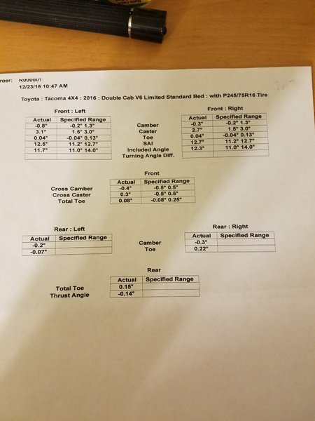

    Previous alignment from 12/16(pulls right)

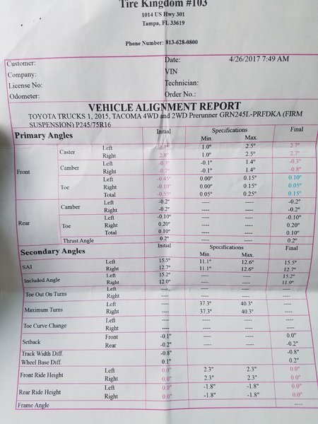

    Previous alignment 4/17(pulls right)

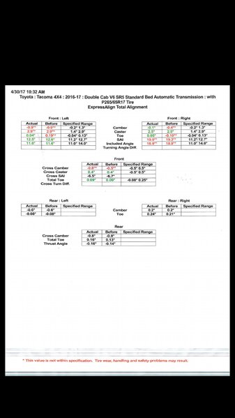

    Current alignment updated 4/30/17
    This past weekend I swapped out my dads stock 2016 trd sport rims and tires to test out if my truck was still pulling to the right. Results are that my truck still pulled hard right, but took a little long to do it( Smaller width and less aggressive tread). I put my tire back on and took it to go get another alignment. My results are posted above and my truck still pulls right. Although it just barely pulls that way and is 100 times better. It will actually go straight most of the time depending on the grade of the road. I will take it back in for another alignment because i got the 3 year warranty with it this time. So it turns out the lift is the problem in my case although the oversize tires do not help.

    So it looks like:
    final camber is 0.7* each side?
    Final caster is 0.3 left and 0.8 right?
    Can't really read SAI. Tthrust angle looks good.

    Camber looks out of spec. on right side particularly Is it pulling right or left? EDIT: I see you said pulling to right.
  18. Apr 27, 2017 at 4:25 PM
    #18
    smitty99
    smitty99 I also bought a 4Runner
    Sep 10, 2015
    #163923
    12,944
    Scottsdale
    16 TRDORDCSB 4x4 A/T (loaded w/ JBL)
    6112s/5160s & 3-leaf AAL;ubolt flip kit;Superbumps
    Final caster is 2.7 (higher than spec) but same on both sides.
    Final camber is -.8 on right, -.3 on left
    angrysam[QUOTED] likes this.

    Final camber is 2.7
    Your correct about the caster.

    right off the bat i can see your front cambers are negative AND uneven. those tires are designed to be run basically flat in camber (0.0deg). correct that first. i didn't look over everything else though, but that must be corrected. have these guys not setup truck tires before? camber like that looks like they're trying to put a streetcar alignment on it.
    i have Cooper ST Maxx E range tires on my Tacoma, and i can tell you if these tires see something to grip then they will and pull the truck that way. that alignment is leaning on the right front tire's inside edge, so i believe it's causing the pull.
