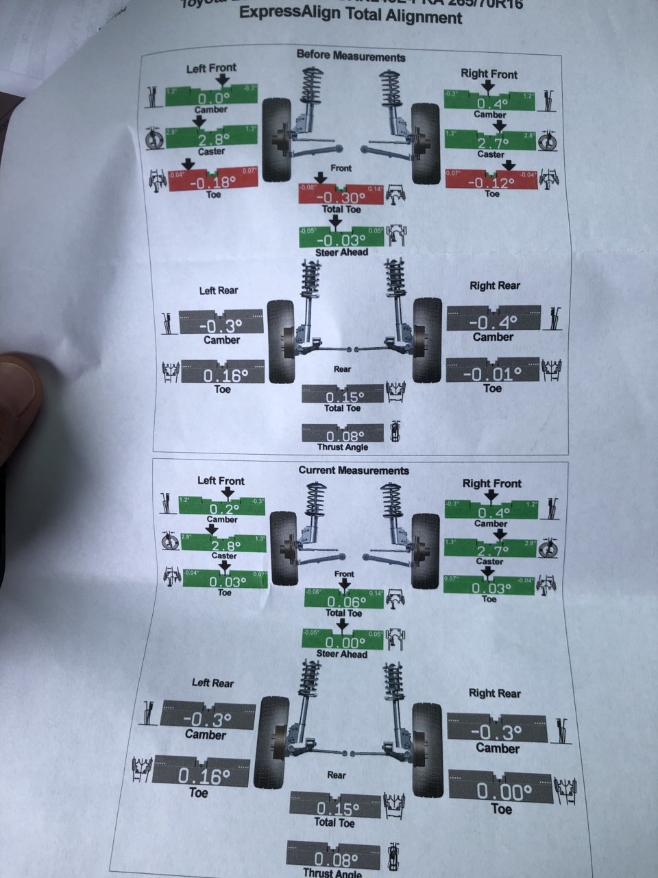

    South Jersey/Philly Area
    1996 Land Cruiser 80 Series
    You check the brakes?
    Evostaco likes this.
  3. Apr 28, 2021 at 1:22 PM
    #43

    The truck pulled before my rear end lift and I didn’t lift it with blocks and spacer I put coil overs up front and deaver leafs in the back
  17. Apr 28, 2021 at 8:47 PM
    #57
    Brian_d
    Brian_d Well-Known Member
    Oct 29, 2020
    #345243
    81
    Socal
    Nope. All it would do is cause dog tracking, where the back wheels don't follow the front wheels. If you've ever followed a car down a road & it looks like the car is in a turn, but it's going straight - that's dog tracking.
  18. Apr 28, 2021 at 9:03 PM
    #58
    Brian_d
    Oct 29, 2020
    #345243
    81
    Socal
    I know I'm late to the party...
    Your printout has "will pull right" written all over it.
    The car is going to pull towards the side with more positive camber: lt 0.2 rt 0.4
    The car is going to pull towards the side with less caster: lt 2.8 rt 2.7
    You generally want .3 -.5 more caster on the right vs the left to compinsate for road crown.
    Looks like they just "set the toe & let it go".
    Did they tell you that your eccentrics were rusted/frozen?
    If not, I hate to say but, then they were just lazy

  19. Apr 28, 2021 at 9:19 PM
    #59
    850_taco
    850_taco [OP] Active Member
    Apr 26, 2021
    #364014
    29
    2011 Speedway blue access cab long bed
    2.5 bilstein 6112 coil overs 1inch rear leaf springs
    @Brian_d thats exactly what I was thinking toyota said it was that I’m thinking my cam bolt gussets are bent
  20. Apr 28, 2021 at 9:45 PM
    #60
    essjay
    essjay Part-Time Lurker
    Nov 29, 2018
    #274276
    3,276
    Concord, CA
    2011 Tacoma SR5 (V6/AC/4WD)
    I'm confused as to why you would think those are bent, when you haven't even actually seen the alignment sheet...
    Edit: Or are you saying that Toyota says they're bent? You'd think the stealership would be all over that.
