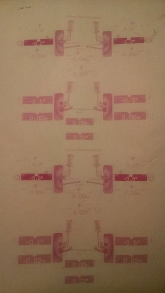

    Got the truck back this afternoon and its about where it was when I took it in. The alignment tech and I talked about it and it just so happens he is a Toyota guy. He suggested new UCA's like a Total Chaos product that were adjustable. He stated that they would improve the alignment and ride. Anybody have any knowledge in this area?

    Sorry guys, by stating that I replaced the entire front suspension I assumed you knew I meant lift or in actuality replaced old lift with new one. Or would have checked out my truck in my profile. Yes, it is lifted, 4" drop bracket to be specific. I replaced old components with new ones, except control arms. Height and everything is the same as before and it was aligned perfectly before...

    Make sure the tie rod bend is oriented correctly. Make sure the tie rod is attached to the bottom of the spindle pickup, not to the top:

    I DID have those beer can spacer's in the first pic on there and I replaced with the tuff country knuckles that are in the 2nd pic. Tie rods are on correctly. Do you/anyone have any knowledge about the long travel UCA's? I've looked into them (Camburg and Total Chaos) and at $400 per side I'd hate to spend that kind of money and not fix anything.

    ^The stock suspension has some anti-dive geometry built in, so it loses caster as the UCA moves down. The aftermarket UCAs are meant to restore caster for strut lifts. Since you have a DB lift with longer spindles, the stock UCA is still at stock angles and didn't lose caster - the alignment printout shows 2 deg caster which is healthy. Aftermarket UCAs likely won't help.
    I think the rack may be leaking/bypassing internally at the spool valve. The PS pump whine may be due to a hydraulic "short-circuit" condition where the fluid is getting past the internal seals in the rack (from the pressure side to return) without doing work, and heating up.

    I appreciate the help Ken. Tapatalk won't let me upload pics so I had to wait until I got to a computer but these are the current numbers on the alignment. It's hard to read but it's all I got from them. Is it possible that they unknowingly aligned it to compensate for the bad rack? It appears that the caster is the only one out of spec but they assured me that it was due to the lift changing the angles. current numbers.jpg

    The picture is hard to read. However, I think I can vaguely make out the caster angles as -0.3 deg L / -1.2 deg R before adjustment, and -0.9 deg L / -0.6 deg R after adjustment. If that's true, then it would explain your steering behavior. Caster is the only mechanism that gives the self-centering characteristic in the steering system. If the caster is 0 or negative, the self-centering characteristic is gone. You want caster to be ideally around +3 deg.
    Looks like the first shop's machine is out of calibration. And yes, the only way to get noticeably more positive caster is with aftermarket UCAs.

    I thought the exact same thing when i saw the caster as a perfect 2.0 degrees on each side. I doubt they actually did an alignment on your car.
    There is no reason to have positive camber on any car or truck. It is common for the alignment specs in their system to sacrifice tire wear in order to increase straight line stability.
    The best specs I can recommend for this or any truck are:
    Camber: -0.4 to -0.6 each
    Toe: 0.05 to 0.10 (0.10 to 0.20 total)
    Caster: 2.0 each or more
    Dont let them tell you they cant adjust caster, get under the car and show them how if the need be.

    Steering was "OK" untill first alignment. Printout #'s are suspiciously near perfect. Now no return to center from right turn.
    Steering seems to be fixed but new printout #'s are way off.
    Hmmmmmm
    1st gen steering pumps are noisy from the factory. Pump wine is hard to judge over the web. Changes in sound over time and steering effort are the best clues to issues without pressure readings.
    As far as internal lekage of the rack control valve. That would result in increased steering effort or a leak. The increased effort would be noticed reguardless of steering position. The control valve does not know or care where the steering is in its range of travel. When the steering is not being turned the valve is in full bypass anyway.
