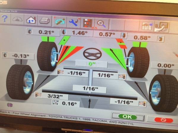

    I checked the alignment today at a shop to verify my numbers. I'm fine on toe and camber, but off from one side to the other with caster (1.46 LF & 0.57 RF). So this weekend I'll try to get both closer to 2.0 on both. (From what I've read that's where it needs to be). I'm hoping that almost 1 degree of difference combined with the 1.5 away from optimum on the RF will Git-R-Done. I had the RF around 1.0 and my big tires were hitting. I guess if that's what it takes, I'll get out the sledge and start bashing more room again, but I'm to the point where it doesn't seem like it's moving anymore.

    Today I adjusted both rear brakes tighter...that didn't help. I checked the brake lines for kinks...couldn't find any. Adjusted the caster so now I'm 1.3 on the RF & 1.46 on LF... seemed to help a little. Getting both to 2 would probably help a bit more (maybe) but At this point, I tired of jack'n with this thing. I've come to the conclusion the 1st gen brakes are just crap. I suspect a lot of guys with 1st gen trucks might not know the difference. I also have a 2nd gen Taco... big difference.
