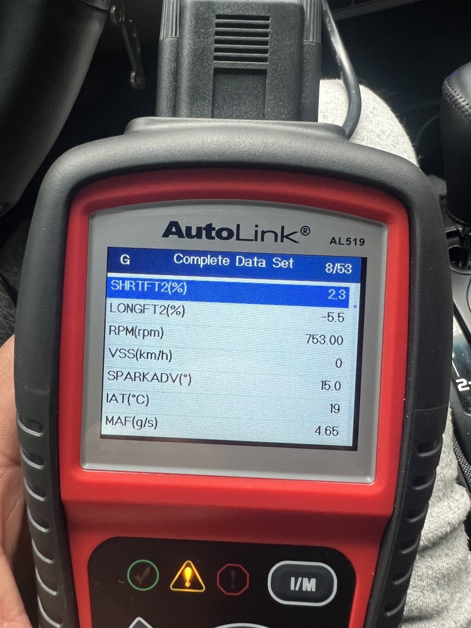

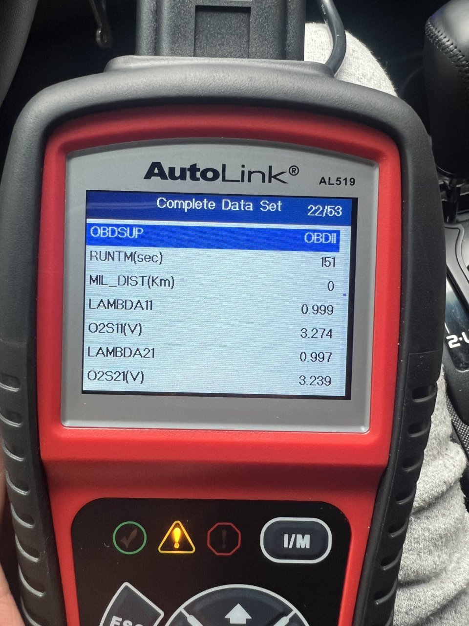

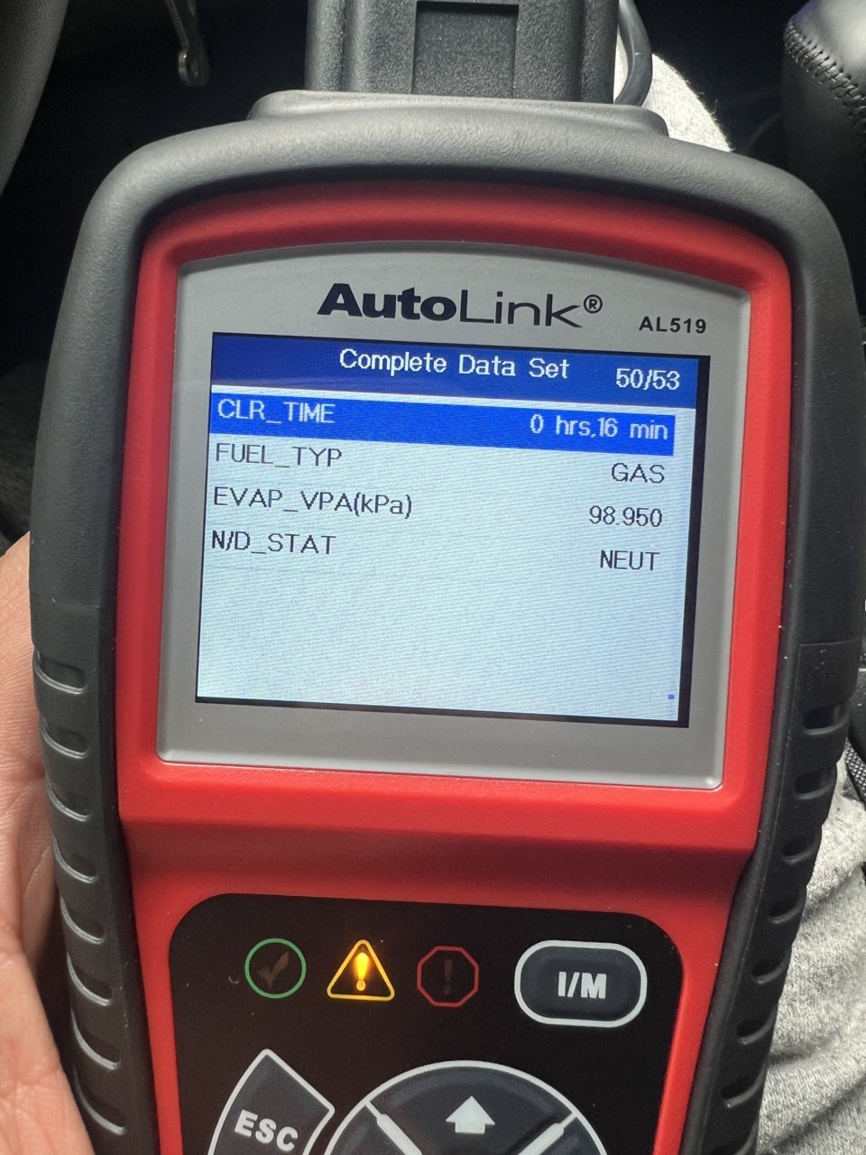

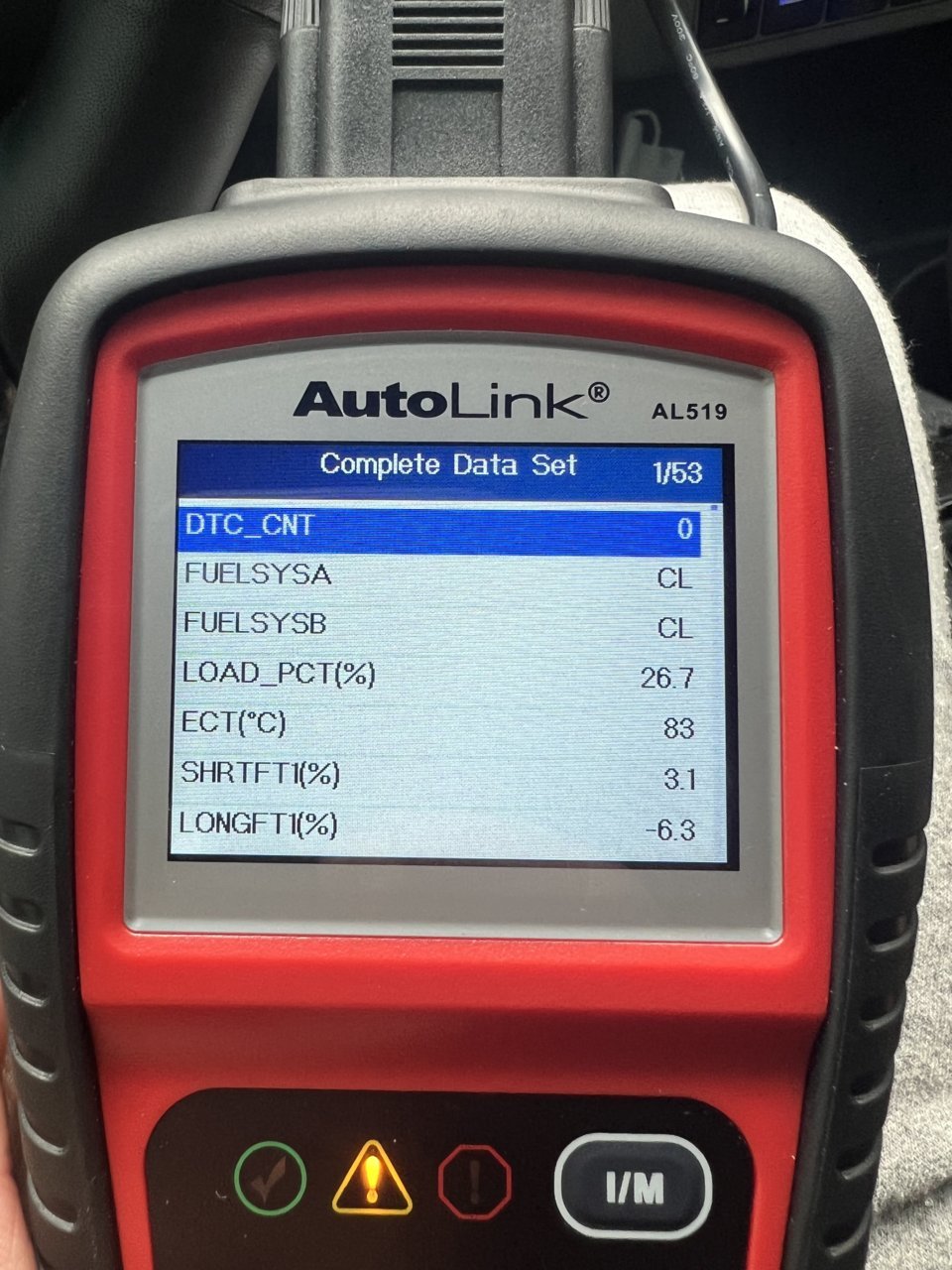

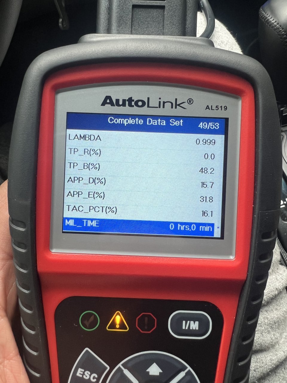

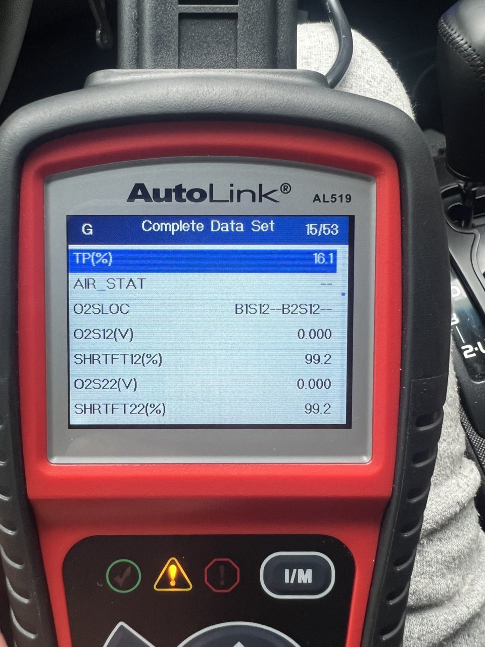

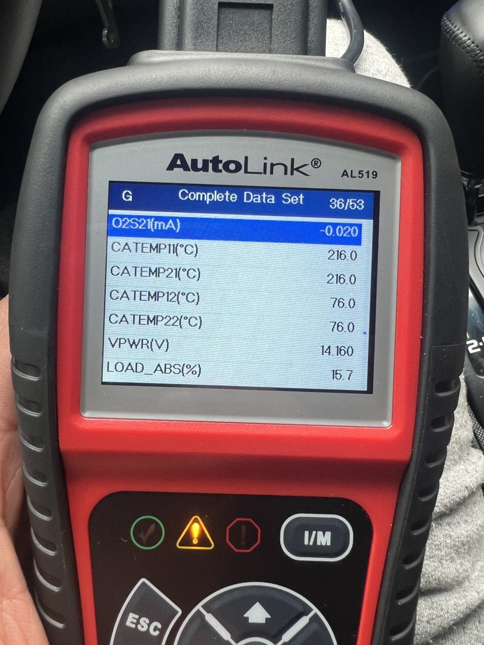

    Not sure if anyone sees anything wrong here.

    All looks good to me, I asked about disconnecting the battery because sometimes cleaning the TB without resetting the PCM can cause idle issues.

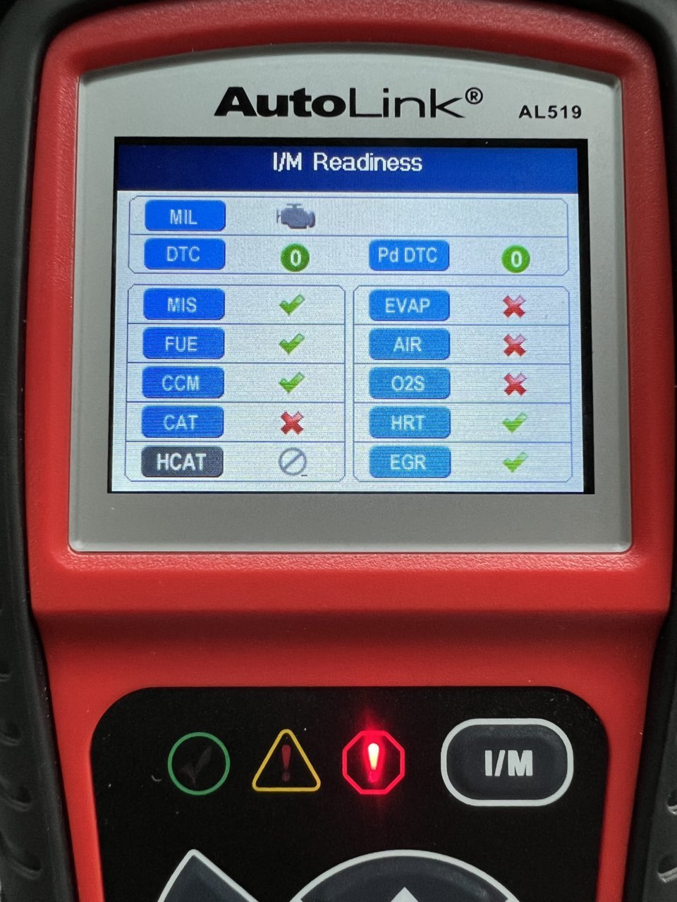

    Not sure if this helps.

    That's just monitors that haven't ran since the codes were cleared, not really useful to look at for your issue.

    I’m stressing…I’m driving my truck as we speak (picking my up son from school) and everything seems perfectly normal. Just doesn’t make sense there’s “pending/possible DTC” but no codes.
