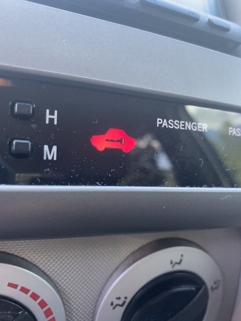

    Is the security light next to the clock flashing with the key on?

    My very brief and limited research says, the immobilizer cuts fuel and Ignition.
    I base this on the description of how the immobilizer work.
    “After the identification results show that the key's ID code matches the vehicle's ID code and the transponder key ECU has confirmed their match, the immobiliser system is canceled and the engine starting controls (fuel injection control and ignition control) enter standby mode.”​
    I would focus on the fuel. I would assume you have a fuel issue, based on the fact the truck will run “on a gas rag”. Fuel to the line doesn’t prove the system is functioning. It just proves the fuel pump is pumping fuel. You need the injectors to work before fuel actually gets into the engine. My next suggestion would be grab a noid light and test for injection pulse.
